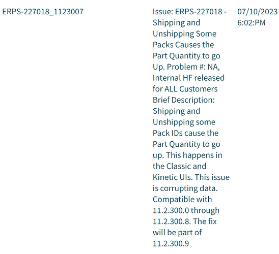

Easily overlooked in the Downloads Section. Make sure to apply this HotFix if going to any version 11.2.300.0 - 11.2.300.8. It includes Erp.Triggers.ShipDtl.dll which has to be replaced on any IIS Application Server. You know it’s serious when Epicor provides a one-off hot-fix.

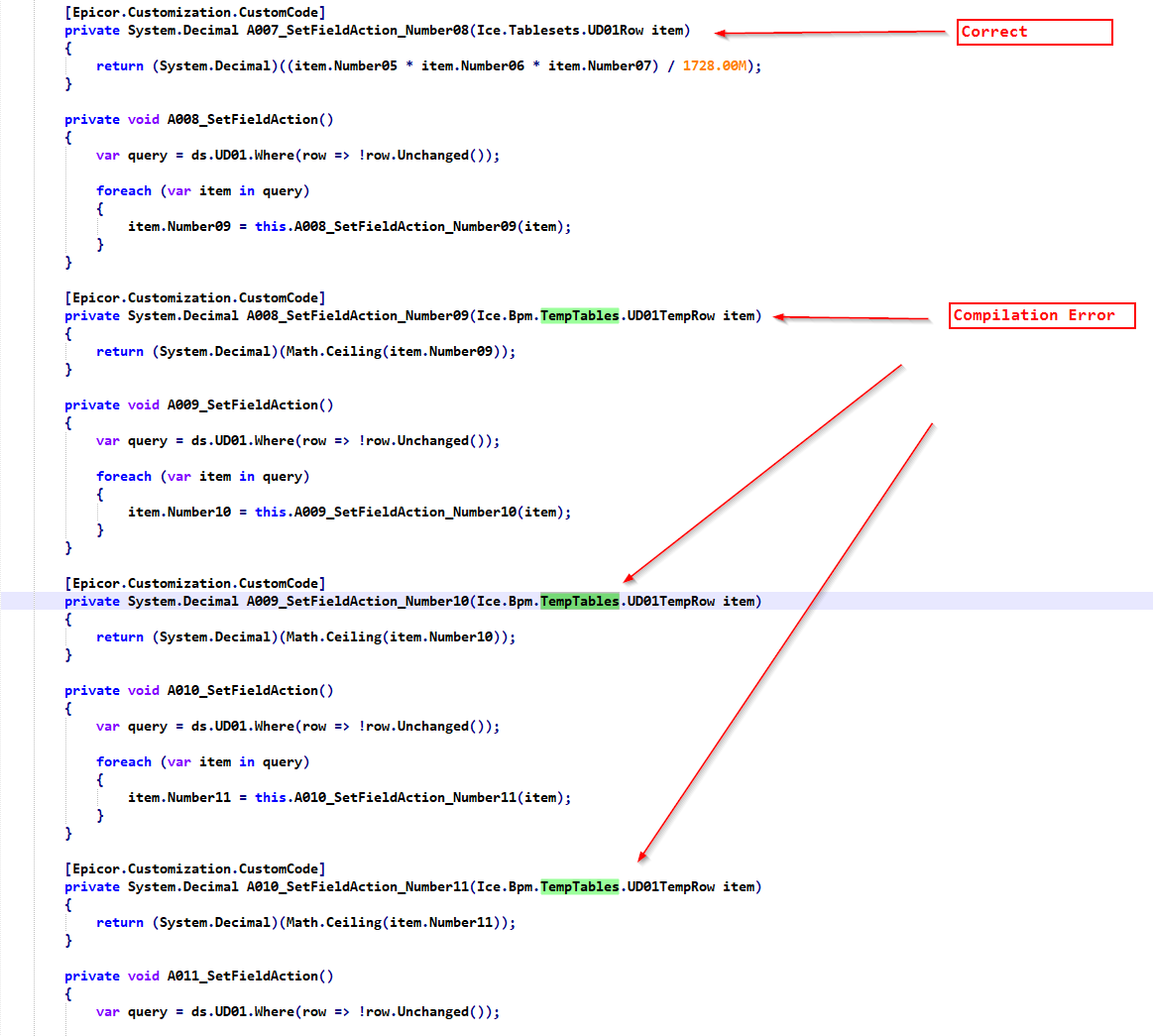

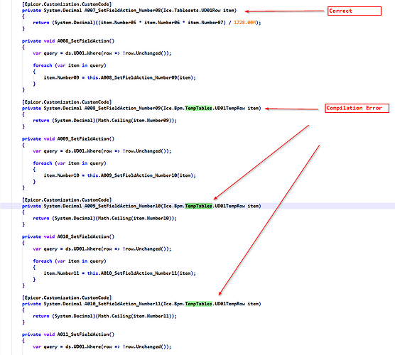

During the Conversion Workbench there are tasks that uplift (convert) your BPMs. In 2023 Epicor now passes the row inside each sub-action, instead of using LINQ always.
// 2022.2
private void A009_SetFieldAction()
	var query = ds.UD01.Where(row => !row.Unchanged());
	foreach (var item in query)
		item.Number10 = (System.Decimal)(Math.Ceiling(item.Number10));
// 2023.1
[Epicor.Customization.CustomCode]
private System.Decimal A009_SetFieldAction_Number10(Ice.Tablesets.UD01Row item)
	return (System.Decimal)(Math.Ceiling(item.Number10));

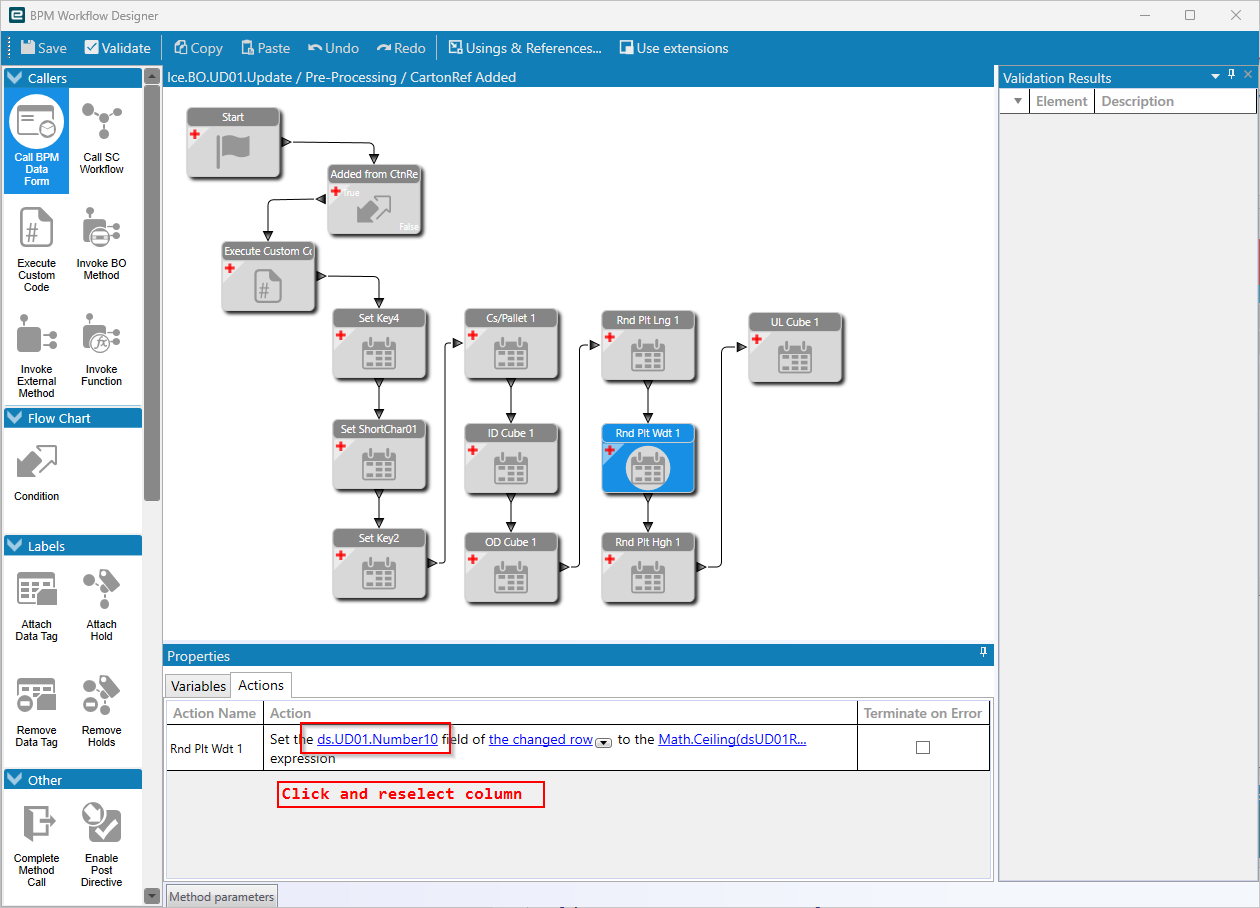

I found that if you have a Set Field condition with your Column wrapped in a Method, like Math.Ceiling(dsUD01Row.Number10) it will not convert that sub-action, somehow it will use Ice.Bpm.Tablesets.UD01TempRow instead of Ice.Tablesets.UD01Row to me the UD01TempRow seems the logical choice, given that we are modifying temp-tables, but it wants UD01Row.

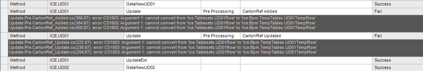

Compilation Error
Technical Cause
Fix

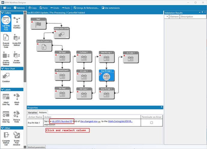

Reselect the Column you are setting, save the BPM and mark as Compatible.
