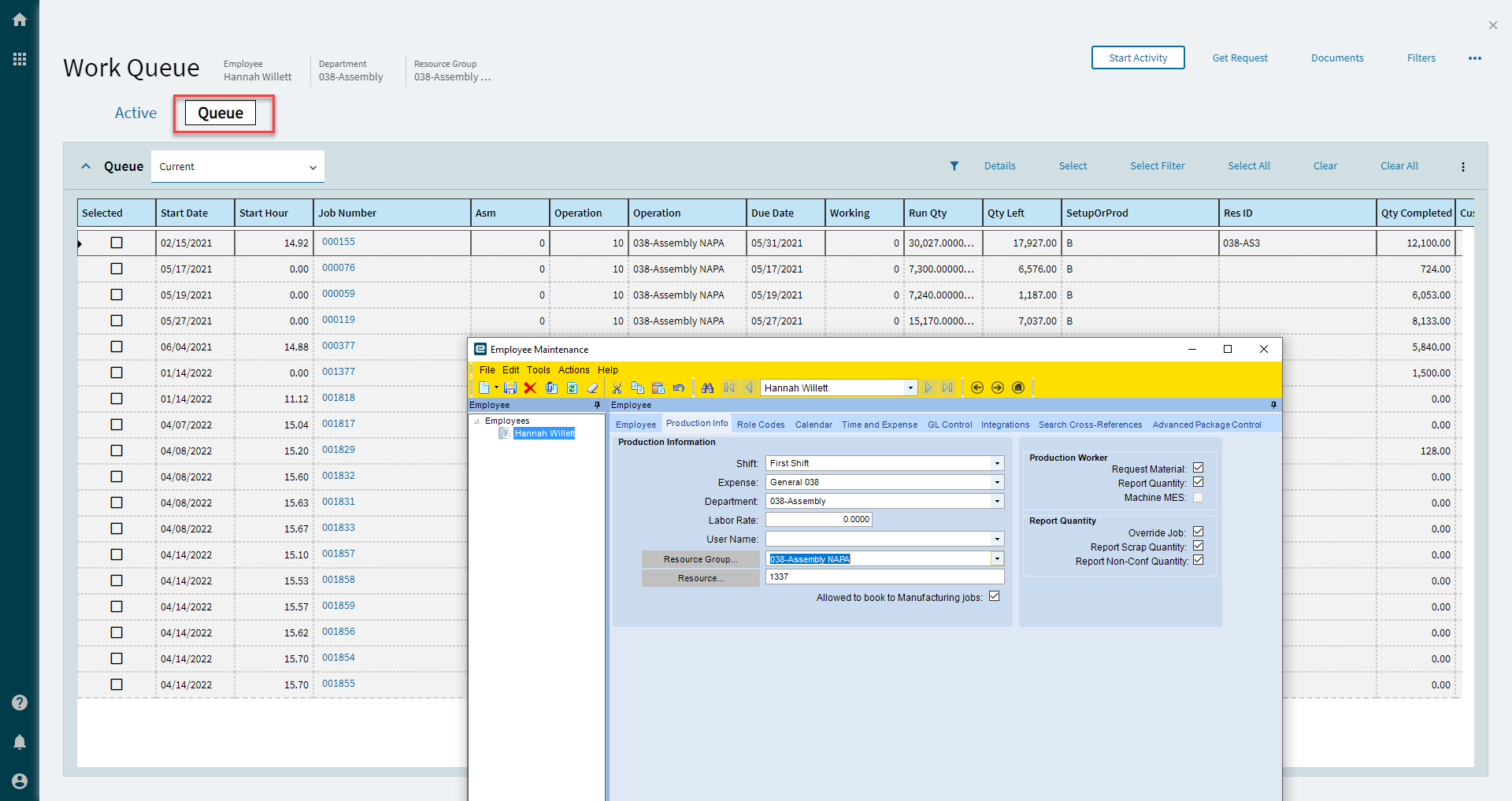

I am playing around in Pilot on 2022.1 and opened up the Work Queue through MES but cannot select any jobs. I tried to search for resources but they came back empty. I was able to log into a job directly but it did not show under Active in the WQ. Is there a setting someplace that I don’t know about? I’m coming from 10.2.500 so was not sure if something had changed in between versions. Thanks.
Make sure the employee record is assigned a resource group.
Additionally, when the Work Queue loads, it opens the “Active” tab. Make sure to check the “Queue” tab.
Thanks @hmwillett . That made them appear.

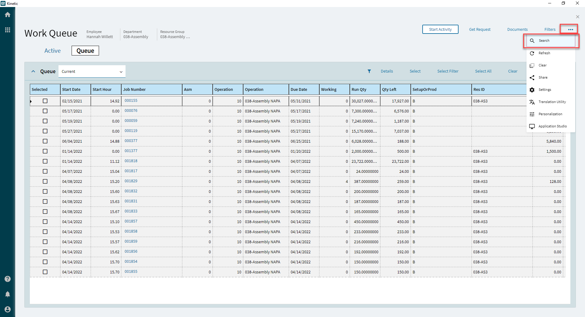

You can search for resources groups outside of your default.

I agree, would be nice to be able to quickly change “resource group” to see other availability. Needs to be quicker, but search is helpful. Thank you for the tip. We were struggling with this.
