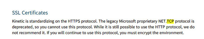

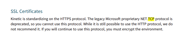

Pretty sure its fully deprecated at this point. It didn’t work well even in 2021.
From the 2022.2 release upgrade guide.
