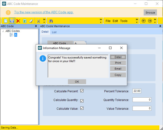

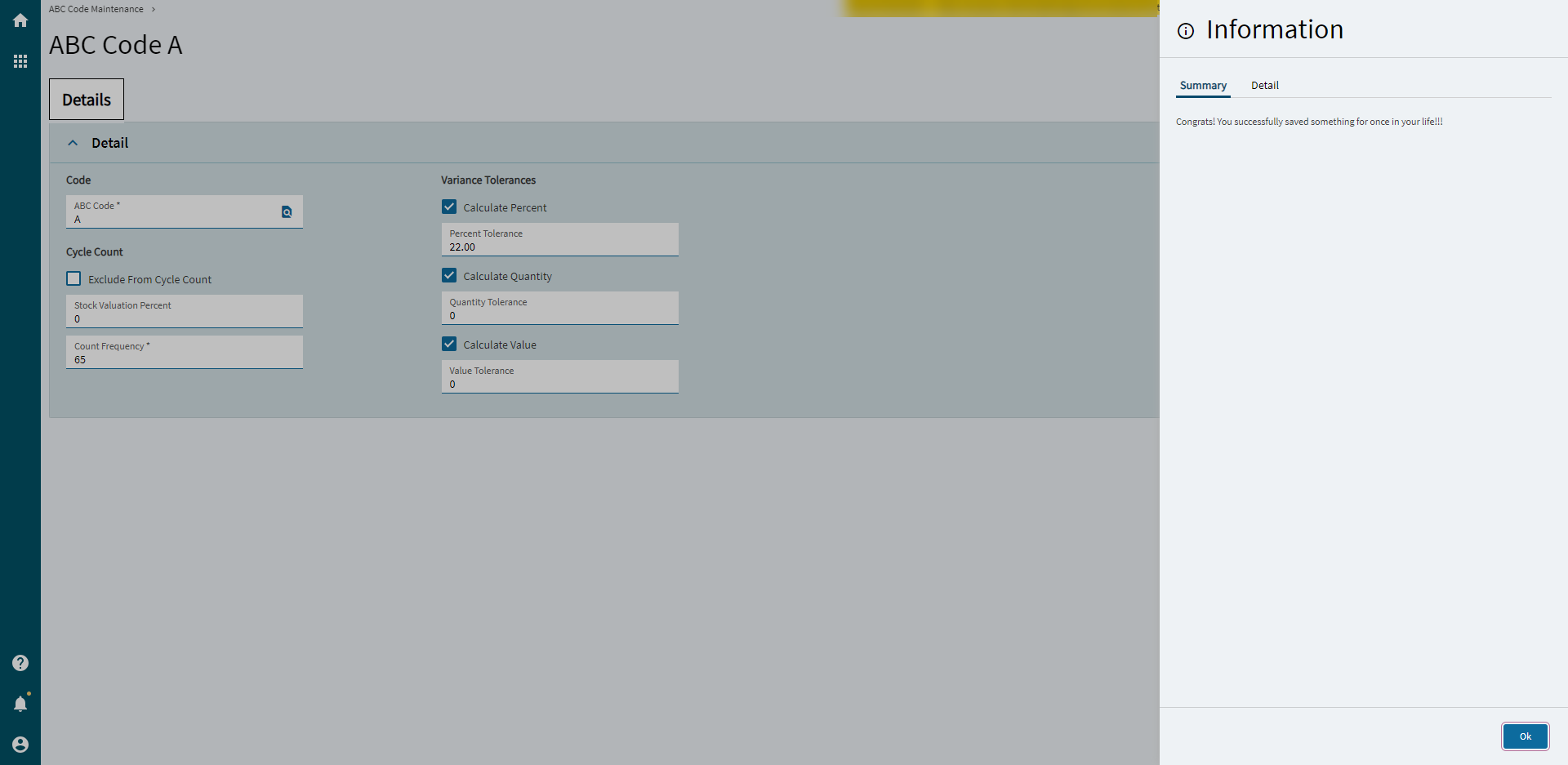

It’s not JUST data directives.
Testing in a UBAQ right now, it’s not working. I thought I was losing my mind.
this.PublishInfoMessage("Your Message Here", Ice.Common.BusinessObjectMessageType.Information, Ice.Bpm.InfoMessageDisplayMode.Individual, "", "");
Is still working.
Okay so it is still working?
InfoMessage.Publish is broken. This.PublishInfoMessage works. But this doesn’t help the hundreds of BPMs that might be using the former…
