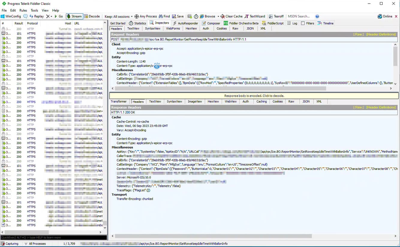

Setting up a testing station now that we can try to capture the lock up on with fiddler. Looking to find out, are we calling out and not getting a response, are we failing to decode a response, are calls still made after the UI seamingly locks up.

New development is we can’t get it to do it when we are using Fiddler for packet inspection, on PCs that otherwise exhibit the issue.
Race condition? We’re running out of ideas. At a point where I’m wondering if it’s a bug flaring up in .NET 4.8. I can’t imagine it would be because of compatibility between 4.8 and 6.0 on the server since GZIP is GZIP isn’t it?
This has been running calling BOs every 10 seconds for about 4 hours without issue when Fiddler is running. Otherwise it will poop out after 20ish minutes. Can 100% isolate and correlate with Compression but… WHY?!

Note, even after enabling deflate server side, all requets from the client go in with an
Accept-Encoding gzip
So IIS does not respond with deflate, it either defaults to gzip (as requested), or if you disable the gzip scheme completely and leave only deflate it will respond with no compression since the client isn’t advertising that it accepts deflate
