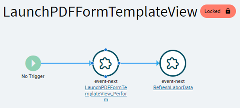

LaunchPDFFormTemplateView (2023.2)
LaunchPDFFormTemplateView (2024.1)

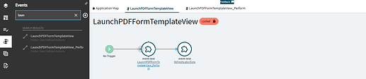

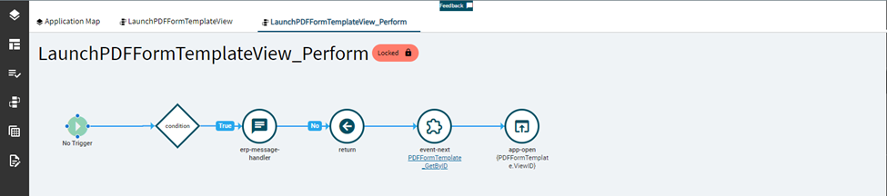

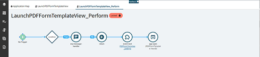

Note that if I search for “Launch” there are now TWO events in 2024.1. For whatever reason, they split some of the functionality out… so when LaunchPDFFormTemplateView runs, the first step is event-next, calling LaunchPDFFormTemplateView_Perform:

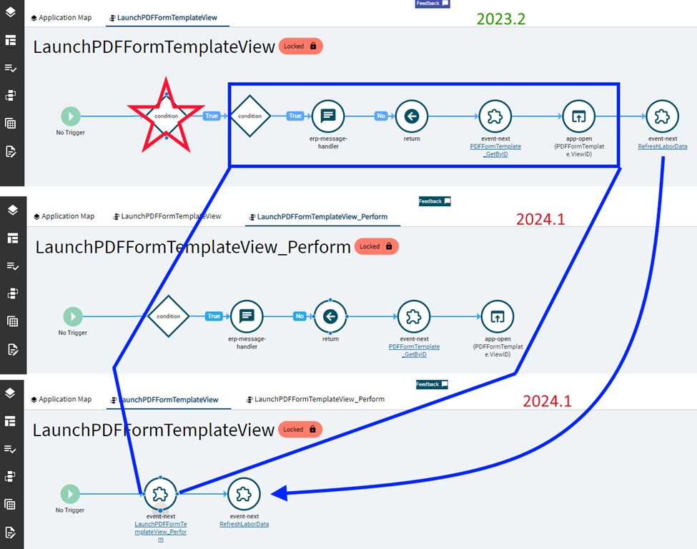

Below is the “mapped out” change:
The problem appears to be, that when Epicor did this “split”… they didn’t include the first condition (starred above).
2023.3 Condition 1:
%LaborDtl.hasRow% && %LaborDtl.count% > 0 && '{LaborDtl.TemplateID}' !== ''
2023.2 Condition 2:
'{sysVariable.prompt}' === 'true'
2024.1 Condition 1: DNE
2024.1 Condition 2:
I’m not even sure what the LaborDtl.TemplateID is… but apparently we don’t use them? In 2023.1 this first condition would fail… and the End Activity process would continue on uninterupted.
In 2024.1 without that condition, we would receive “Record Not Found” errors, because it was looking for a LaborDtl.TemplateID of (blank/null/etc./??)

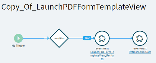

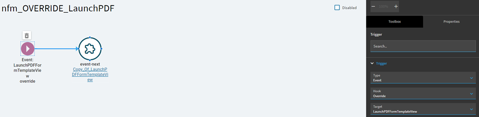

Anyway… to get around this, I made a COPY of the base (Locked) “LaunchPDFFormTemplateView” event.

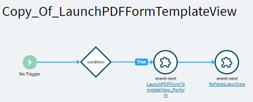

In my copy, I re-inserted the missing condition:

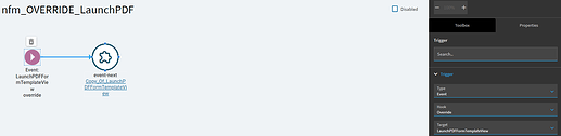

I then created an “Override” event.
- Trigger: Event, Override, LaunchPDFFormTemplateView
- Event-next: Copy_Of_LaunchPDFFormTemplateView
So, now when I end an Activity, instead of running the stock event, my event kicks off instead which includes the original condition from 2023.2… and all is hunky-dory again.
