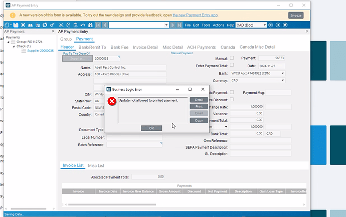

If you try to add a payment to an AP payment group in AP payment entry:
The group creates okay.
If the payment method uses Check Printing as the Pay Method type you get the error Update not allowed to Printed Payment.
This error pops up immediately and over and over when you try to do anything else like delete the line or click a menu item. The only action that stops it is clearing the form.

On the error you showed, just click on detail and paste the output here - let’s see if there are any more clues.
Epicor has escalated this to problem PRB0291092
As of this morning there is no ETA even though the update is next Friday.
Business Layer Exception
Update not allowed to printed payment.
Error Detail
Correlation ID: e55b50af-d2c1-43c3-a2f3-66ba8f30e609
Description: Update not allowed to printed payment.
Program: Erp.Services.BO.PaymentEntry.dll
Method: CheckHedBeforeUpdate
Line Number: 5637
Column Number: 21
Table: CheckHed
Field: CheckNum

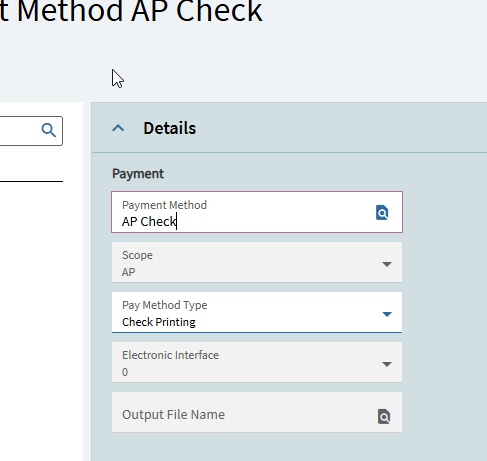

The Method Type is the issue. If the Method type for the Payment method isCheck Printing it blows up immediately.
I can use any Payment method but if the method type is Check Printing it immediately errors out.

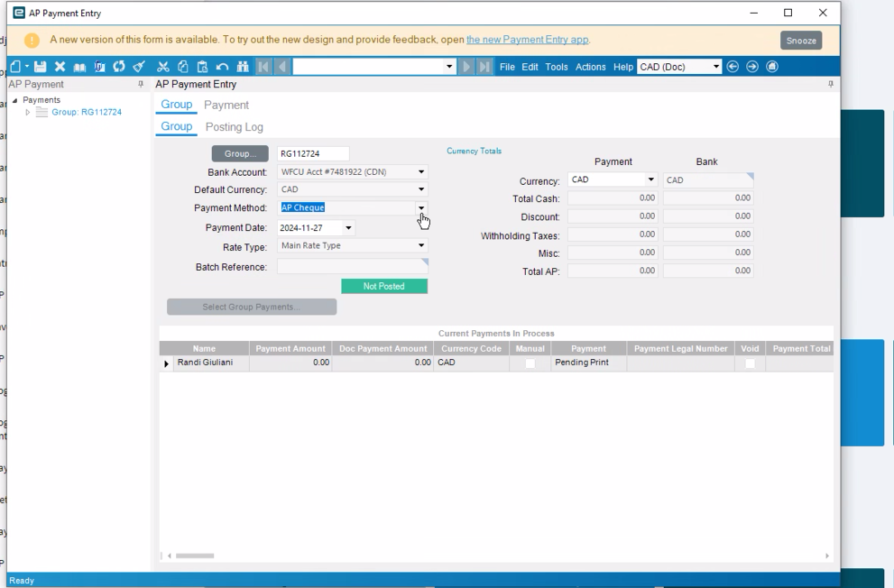

Here is what I did, are there any other steps I am missing to get the error?
-Create new group
-Type in group name
-Save
-Overflow menu > Select invoices, select some invoices and click ok
-Go into one of the invoices
-Change the description, save again

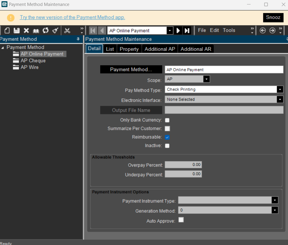

We are getting this error even for cases where the Payment Method type is NOT ‘Check Printing’ - it’s been in Epicor’s hands since November 14 and we are still waiting on an ETA for this fix.
