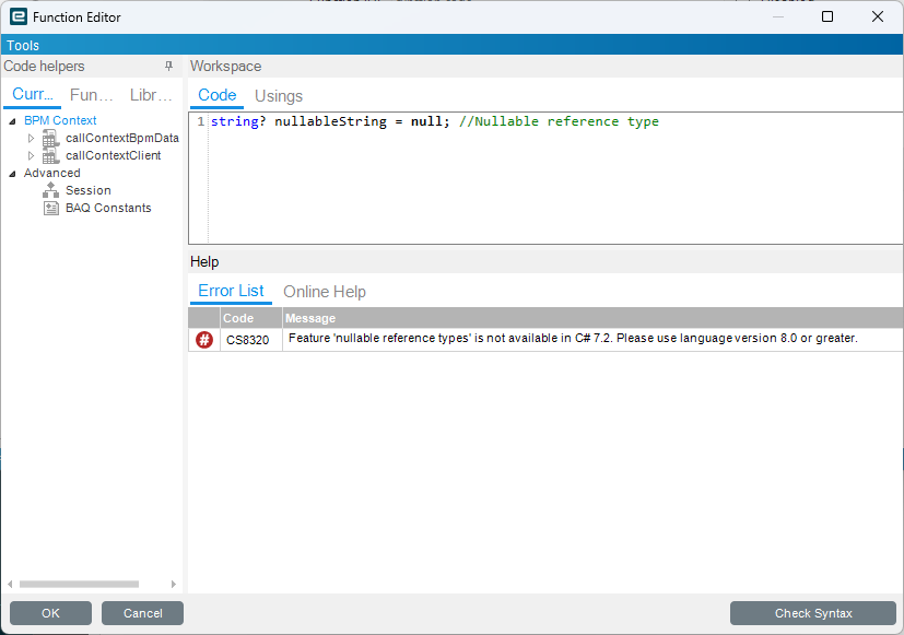

FYI - Our developer said that functions (guessing on the client) supported 10+.
it won’t chnage anything now, when both clients are supported.
Interesting, I will check that.
Functions are on 7 though.
yes, google says that
The .NET Framework 4.8, which is the last version of the .NET Framework , supports C# 7.3, and newer versions of C# are only available in the newer .NET platform.
so technically BPM also could use that version
not 10, 7.2
It always has annoyed me how BPMs and functions are on different language levels.
So we’re limited to C# 6 for BPM’s and C# 7.2 for functions in 2024.1 through 2025.2? I must have gotten confused at Insights last year. Not unusual when I’m drinking from a fire hose!
