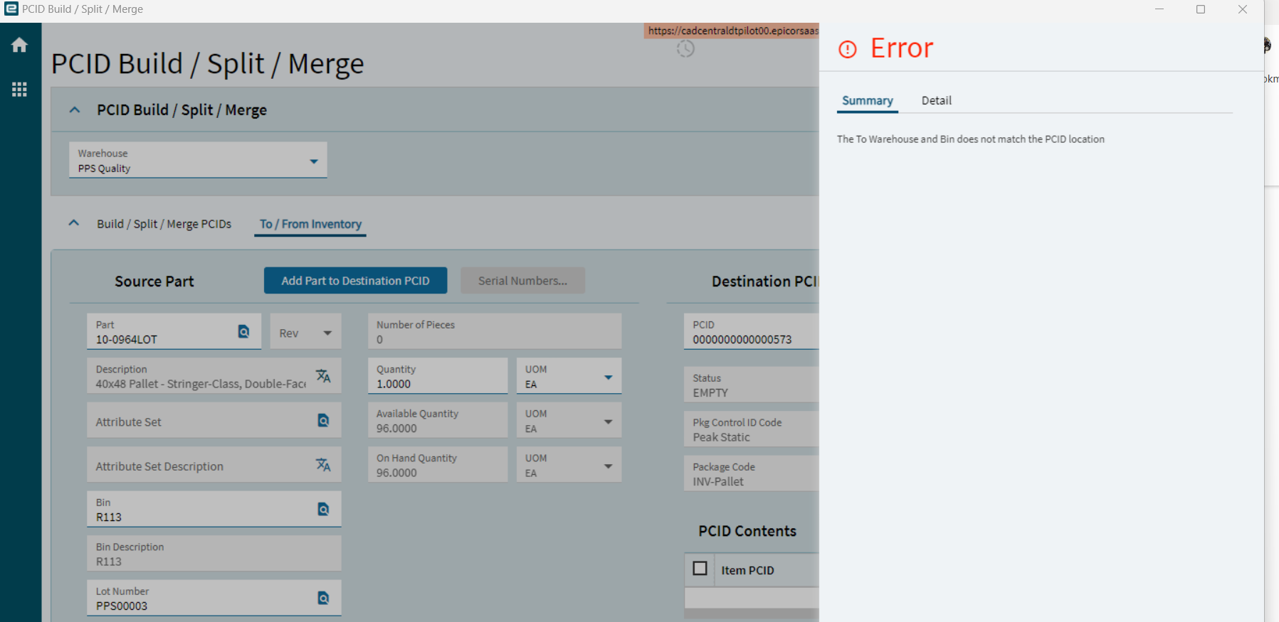

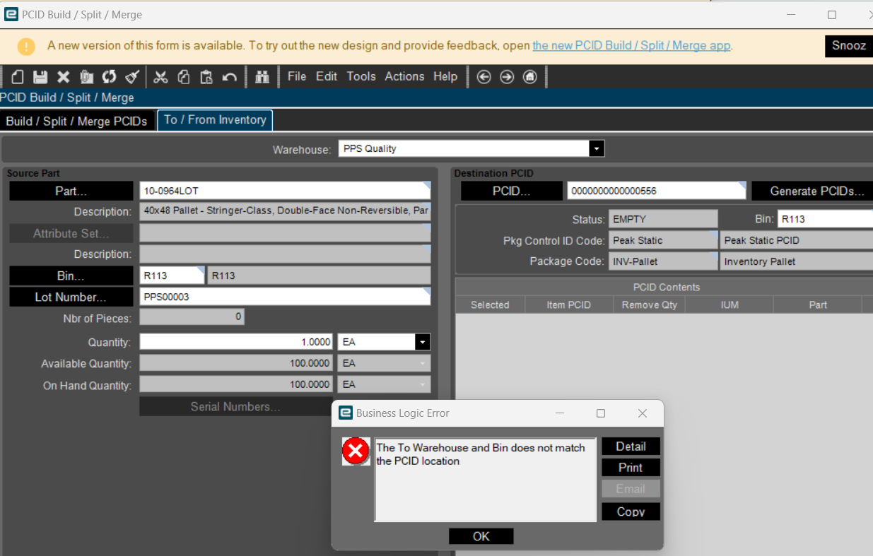

We cannot add parts to new PCIDs.
It says the Bin does not match. It does not matter if I type the bin, copy paste the bin. The default bin in Package Control ID configuration is the bin that I used in this example, same with the warehouse. They match the part.

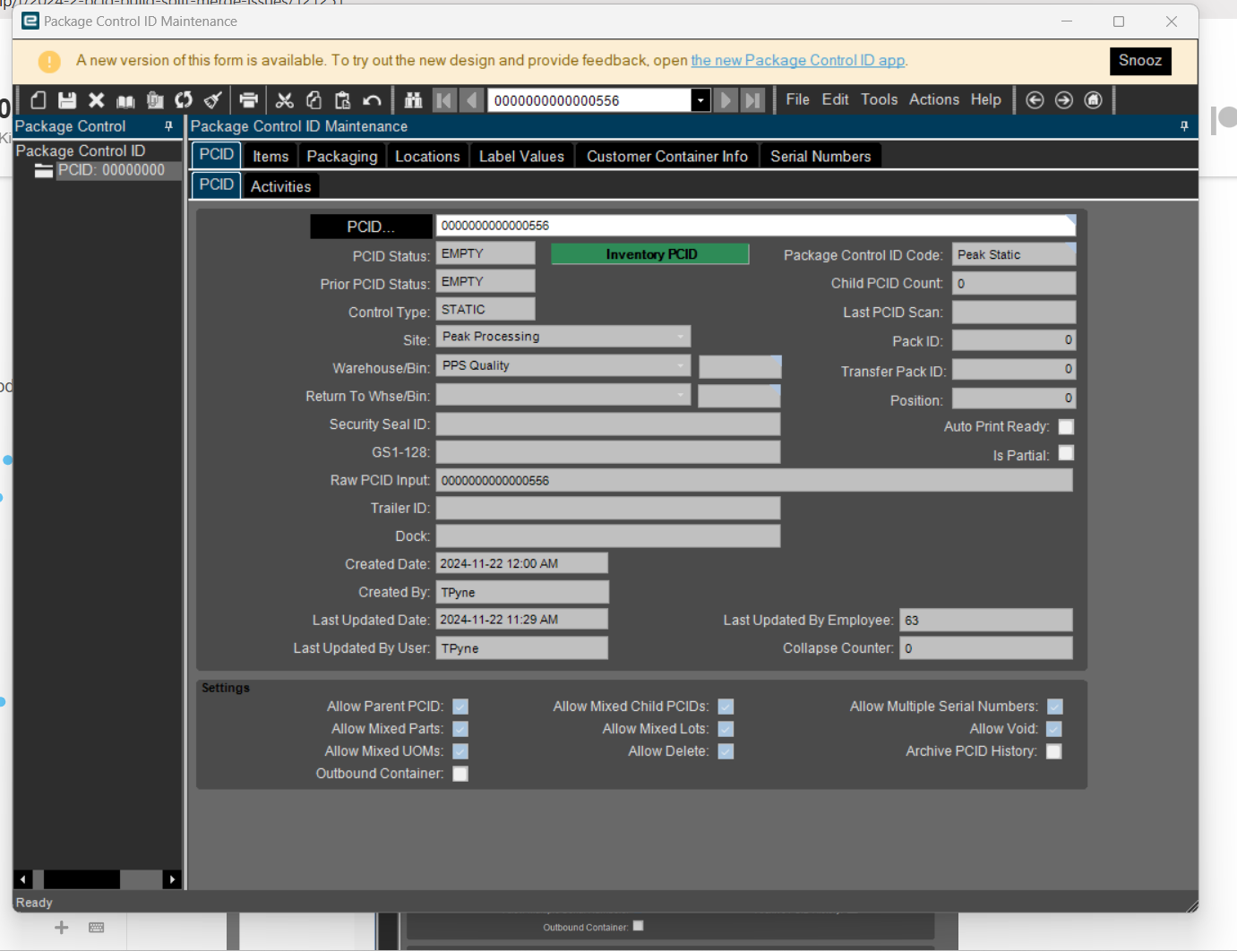

  1. If it is an existing PCID that has a bin (because a part has been added to it) we can add a part to it.
  2. If I use a UBAQ or something to force a BIN Number onto the PCID it allows the part to be added.

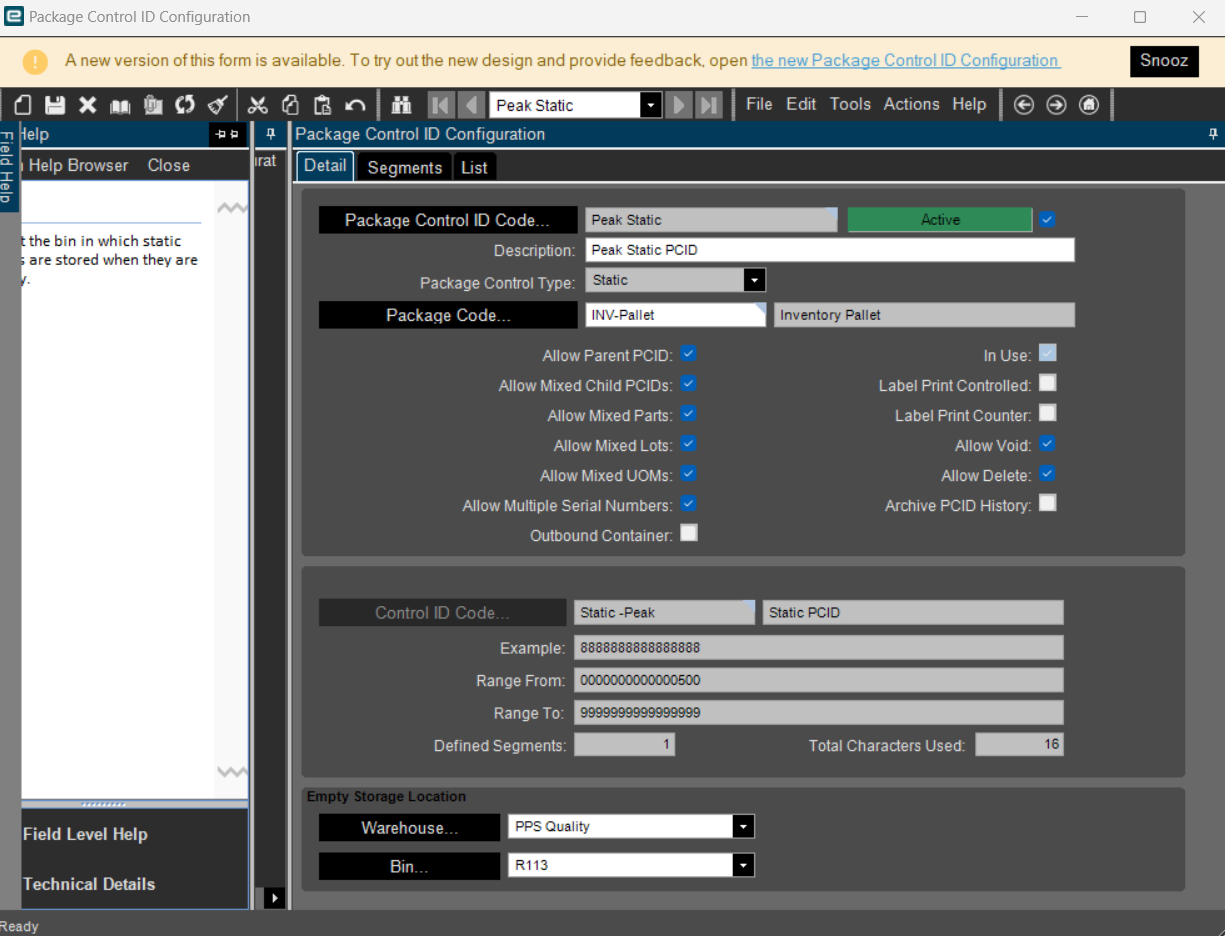

I always wondered why you could not specify a bin when creating the PCID. The configuration has one but it doesn’t seem to do anything. Help states it sets the bin for empty static PCIDs but does not.

It is the only typing that one does during the adding parts to PCID process. How could it be missed? I’m glad I built a workaround but that’s something I did in Pilot to speed up the process

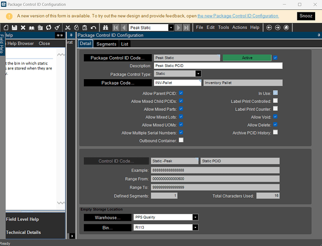

Is it possible the bin R113 exists in multiple warehouses?
Can you show the Package Control Maintenance screen for “Peak Static”?

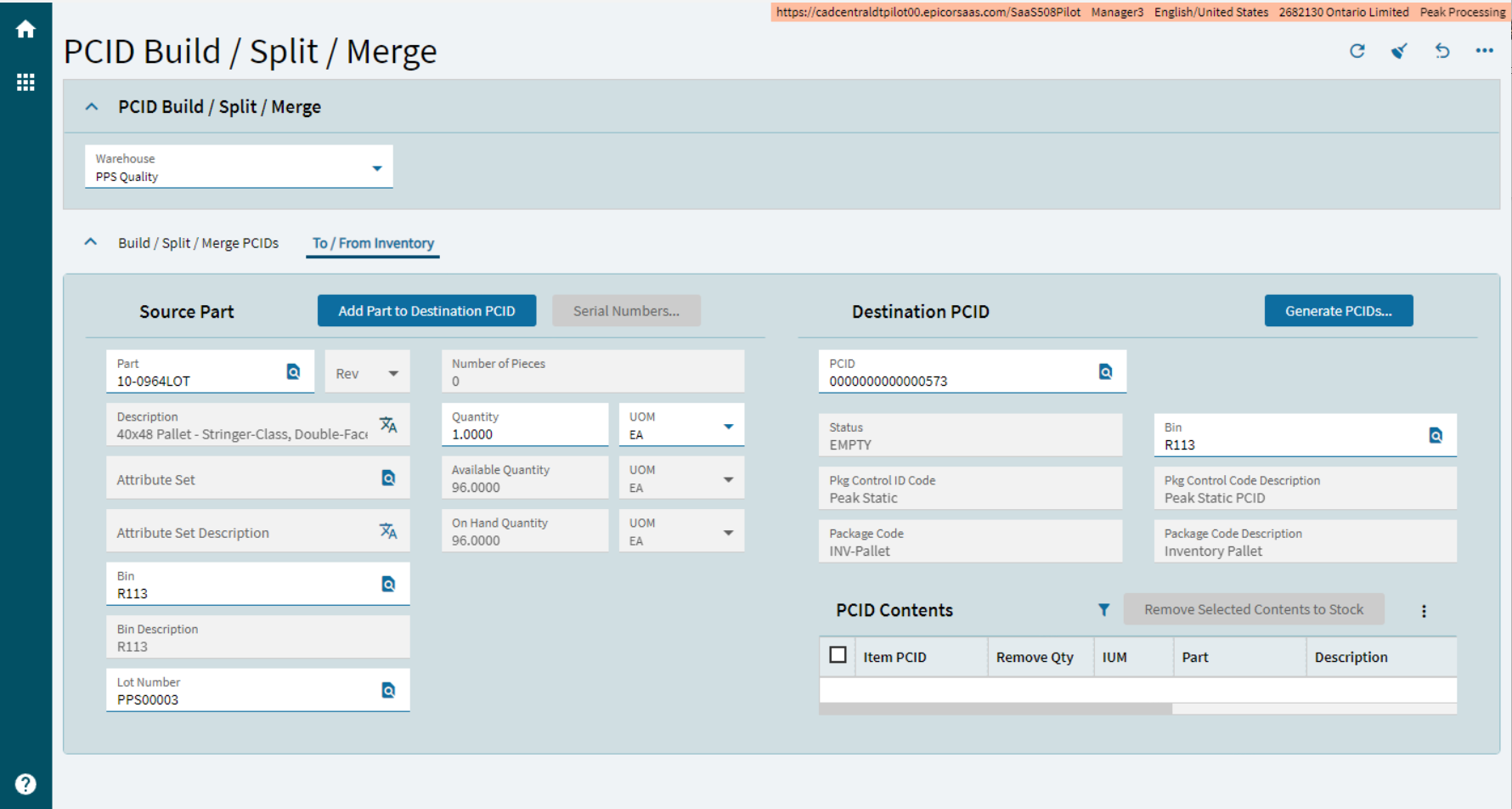

Have you tried in the new UI?

The only difference was the Dynamic Configuration had outbound on (which could not be changed for the static) and Allow multiple serial numbers was off.
I turned it off for the static PCID configuration made a PCID and still got the error.
Same with the new UI

There is one data entry text box on the PCID side of the screen.
It’s mandatory and no longer works.
This has been working since 2022 for us and now fails consistently with 2024.2
