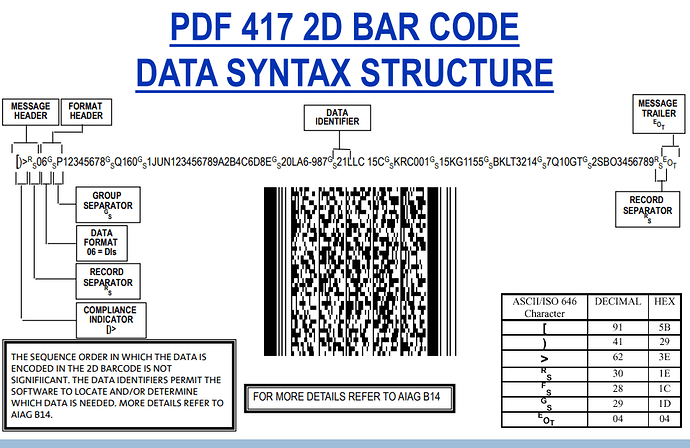

Certain Customers do… Example of doing business with GM but they usually send over a Label Requirements Doc.
https://www.epiusers.help/t/showcase-general-motors-supplier-label-requirements/48938
I see, thanks for sharing.
That is one consideration when you are making a barcode… will this be used externally or internally only.

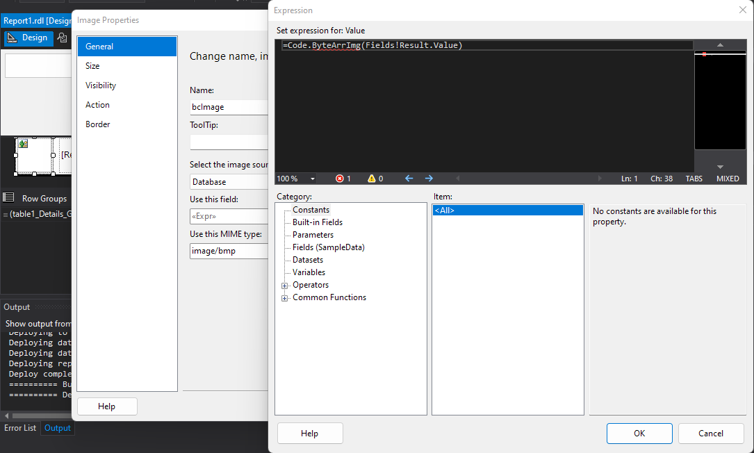

Thanks here is all it takes to make one in my SSRS reports:
