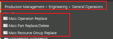

If you can identify duplicate parts and define the numbers to be used going forward, then I would think it wouldn’t be too hard to clean up your methods… either via DMT if you are licensed or… maybe using “mass replace”?

The mass update of the BOM would not be an issue for me. We’ have MASS REPLACE and DMT and Id be done tomorrow.
