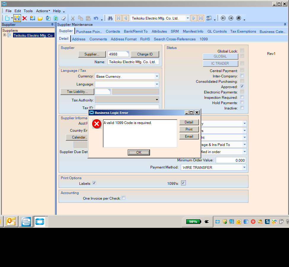

We are upgrading to E10.1.600 from E9. To do our own reporting using E9 for 1099 vendors, we check 1099 on Supplier entry and then use our custom report to do what we want.
Now the system will not allow us to do this stating “a valid 1099 code is required”.
If we try to setup A MISC code, system asks for a 1099 Form type.
There doesn’t seem to be anywhere to enter a 1099 Form type to make it available in drop down for 1099 code maint?!
Anyone have any ideas? I’d hate to have to use a UD field to carry data that we used to do with system standard 1099 field on vendor :frowning:

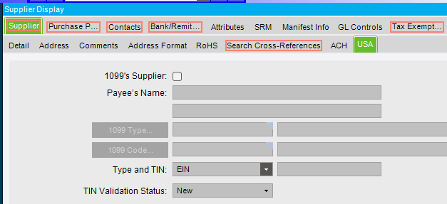

Did you setup the code and box for 1099 under Financial Management - Accounts Payable - Setup (1099 Code and 1099 Box)

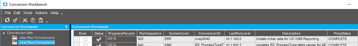

There is also a standard conversion to create the initial data for 1099 processing. That is under User Run Conversions and has the description Create initial data for US 1099 Reporting

Quick note for any dedicated hosted customers finding this - I had to run conversion 920. We did not have anything at 9010. The conversionID is cvap0042

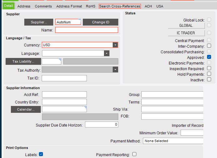

After digging into this a little further I found the fields mentioned above. Turns out that we actually process 1099’s outside of Epicor, though we do use the field ‘PaymentReporting’ to identify them as such. If that field is checked, the field ‘TINType’ needs to have a value in it.
