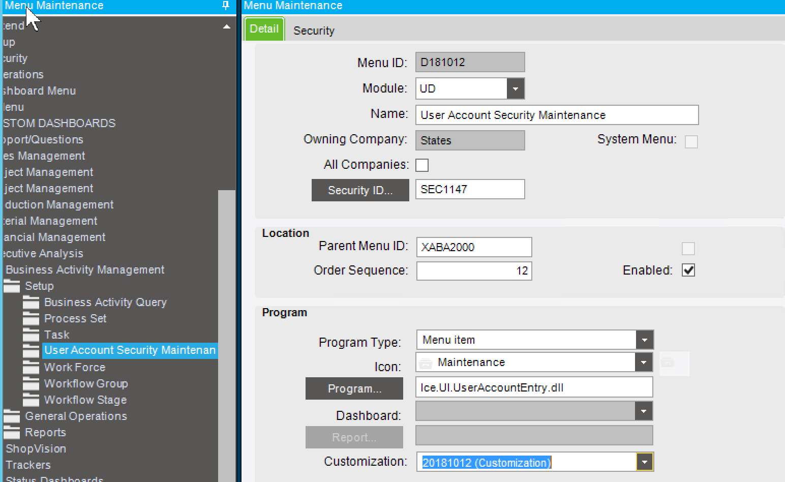

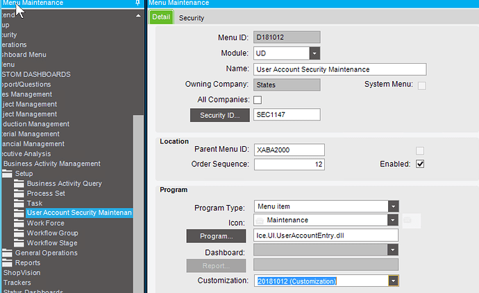

First Customize the User Account Process where you disable the Security Manager Check box.
Save the customization
Open up Menu Maintenance and copy the menu item to somewhere else on the menu by changing the parent Menu ID
Last - either create a new security ID or select another and put it on the menu.
Make sure to uncheck the security manager required on the new security ID.
