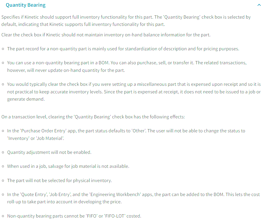

I think your parts are not setup correctly. Here’s what the help says for qty Bearing.

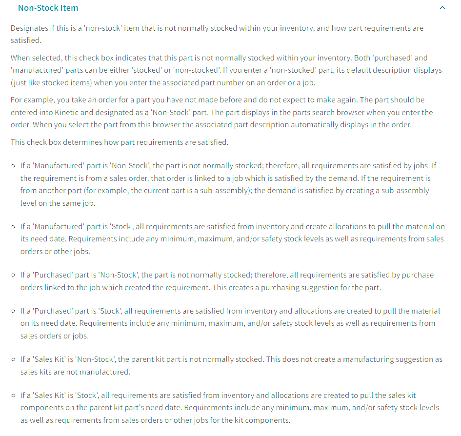

Here’s what it says about Non-Stock
You can still Purchase a non Qty bearing part, but it will come under the “Other” part type which also gives you the ability to edit the GL account in the release (or not).

EDIT, sorry about the crappy screen shots.
