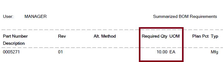

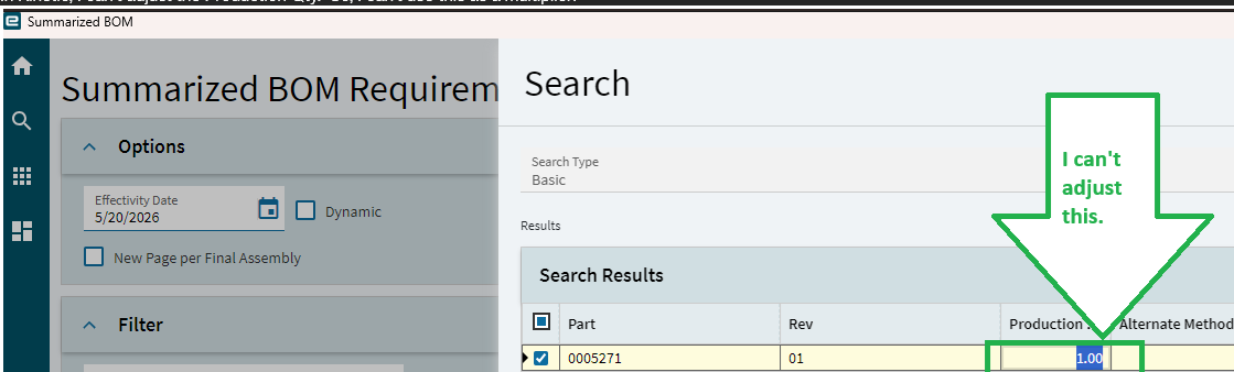

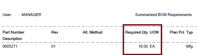

In the Classic view of Epicor, we used to have the ability to define a certain “Production Qty” that, once defined, would impact the quantities of the associated BOM items within that Revision. The production qty is used as a multiplier in the report but is displayed as “Required Qty” on the report(2nd screenshot). This ability has been removed in Kinetic. We reached out to Tech Support and they said, “This is as designed and there are no plans to allow users to do this same thing in Kinetic.” Since they removed the ability to do this, which makes no sense, how is anyone on here getting around this limitation? Our engineers heavily relied on this and is now a major pain point. Any help, ideas, or hacks is appreciated.

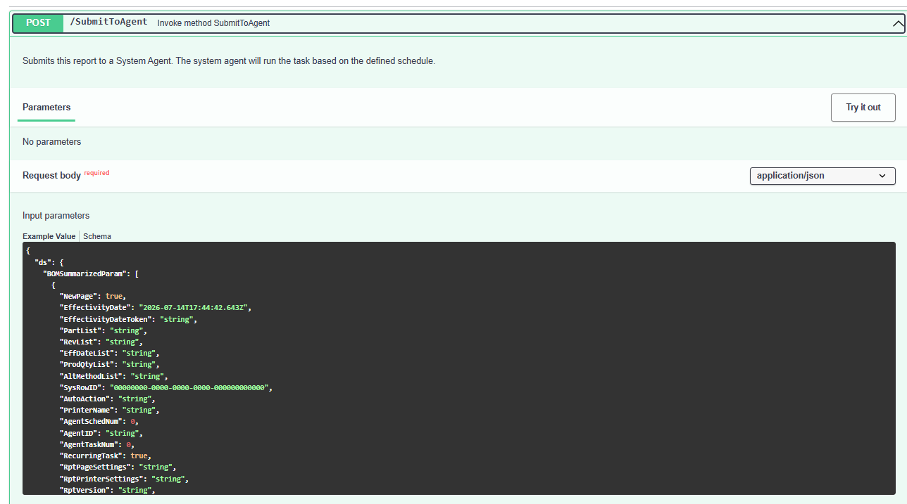

Looking at the REST call, the feature is still there:
It looks like there are multiple lists passed in for Part, Rev, Effective Date, ProdQty, and Alt-Method. You should be able to customize the page to add those back and bind them to the submit dataset.
