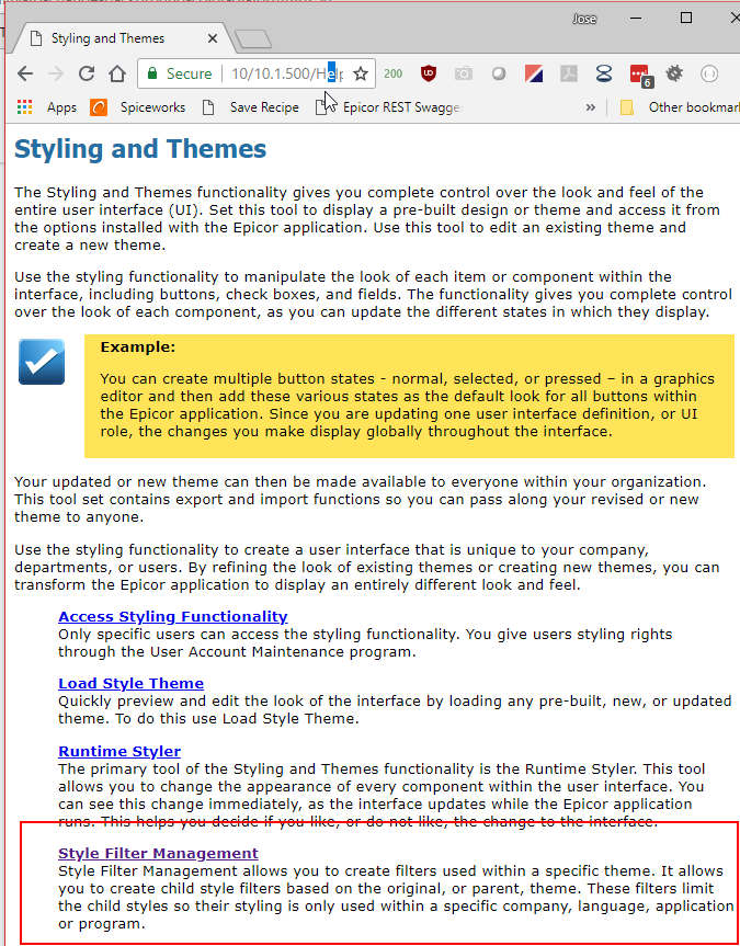

Or maybe such thing exists and I do not know about…what about having a theme applied (something similar to coloring setup of the main form menus , something similar could be applied for the plants?

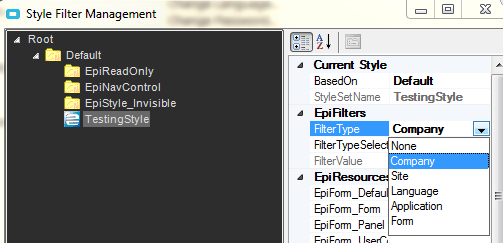

Jose - Can themes use logic? We do a monthly refresh of our PILOT and TEST db’s from LIVE. It’d be nice if there was a conditional that said - If db name != Live, then TestTheme.
Jose - When I pick the FiterType = Company in the Style Filter Manager, There’s only one to choose from, which is the Company.Name field (we are single company/site), and in FilterValue, it shows Company.Company.
Is there a way to make selecting a child them automatic (i.e Company.Name <> “ESAPCO”), or do we have to select a different child theme every time we refresh the environments? Thanks!
