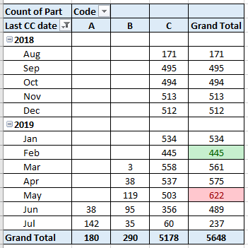

ABC codes and cycle counting. Great fun.
One thing I learned (thanks to @Graemer) about cycle counting is that you have to wipe out every “last cycle count date” before you run Initialize Last Cycle Count Date, and this actually requires a data fix from Epicor since the field (PartWhse.LastCCDate) is read only. So that’s great.
But even beyond that, this is the distribution that Initialize Last Cycle Count Date comes up with even with a blank slate.I’ll ignore July-August because I ran it in August. It’s still all over the place. I did this pivot by value and usage also (not shown; with numbers from the calculate ABC report I did just before this), and it’s all still just as random.
Then I did some actual cycles in test. (I excluded zero OH.) It’s even more extreme.
So, the algorithm stinks. Fine. But can you at least let me do my own math and set my own dates, Epicor? Why is it read only?!
