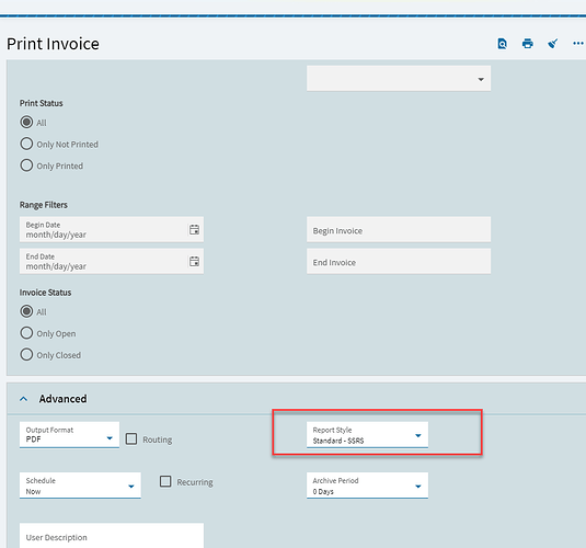

This was what I was meaning. For executing any of the reports in the system you are interested in select the Standard SSRS report style. Here is a screen shot of the invoice print.
This will give the standard output.
Thanks Hally, I will generate them that look like your example.
