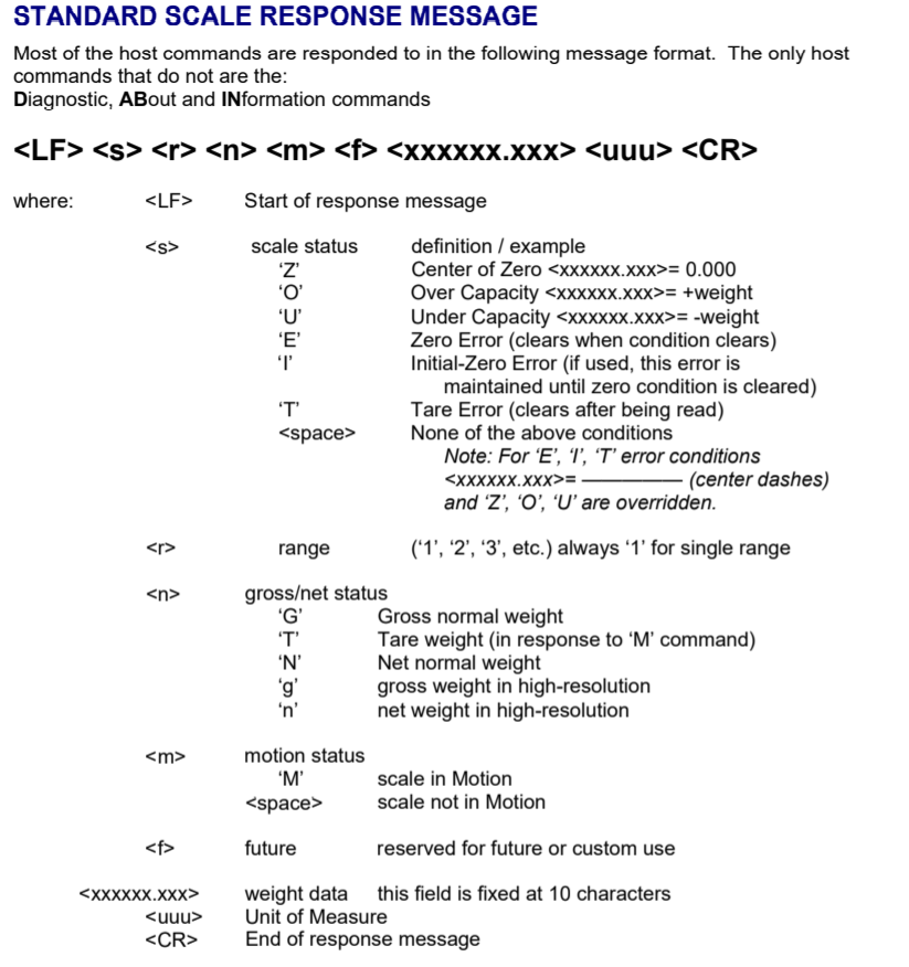

When dealing with scales in the past, one usually just sends a CR or LF to the scale and it returns what’s going on. The code above is generic and is search your port space to find the scale. You’ll know what the port is, so that code is easy. Check out pages 173-4 in this Fairbanks scale guide.
You just send a LF. It sends back a string and you parse it out as described. There are examples of how to open the port in the message above at the Microsoft Docs site.This can all be done in a Customization.

I put this together to read from a set of pallet wrapping scales that we have. Activated from a button click, but had to do some dancing around with event handlers or listeners rather than all of the code being on a button click:
using System.IO.Ports;
public class Script
	SerialPort _serialPort = new SerialPort("COM11", 9600, Parity.None, 8, StopBits.One);
			this.btnWeigh.Click += new System.EventHandler(this.btnWeigh_Click);
			_serialPort.DataReceived += new SerialDataReceivedEventHandler(sp_DataReceived);
			this.btnWeigh.Click -= new System.EventHandler(this.btnWeigh_Click);
		// Begin Custom Code Disposal
			_serialPort.Dispose() ;
			_serialPort = null ;
			_serialPort.DataReceived -= new SerialDataReceivedEventHandler(sp_DataReceived);
		// End Custom Code Disposal
	private delegate void SetTextDeleg(string text);
	private void sp_DataReceived(object sender, SerialDataReceivedEventArgs e)
		string data = _serialPort.ReadLine();
		double weight = Convert.ToDouble(data.Substring(6, 8));
		numActWeight.Value = weight;
		try
			if(_serialPort.IsOpen)
			_serialPort.Close();
		catch(UnauthorizedAccessException ex)
			MessageBox.Show(ex.Message);
	private void si_DataReceived(string data) { numActWeight.Value = data.Trim(); }
	private void btnWeigh_Click(object sender, System.EventArgs args)
		_serialPort.WriteTimeout = 500;
		try
			if(!(_serialPort.IsOpen))
			_serialPort.Open();
			//_serialPort.Write("READ\r\n");
			_serialPort.Write("GR10\r\n");    // Added by MD - get decimal places from scale
		catch (Exception ex)
			MessageBox.Show("Error opening/writing to serial port :: " + ex.Message, "Error!");
