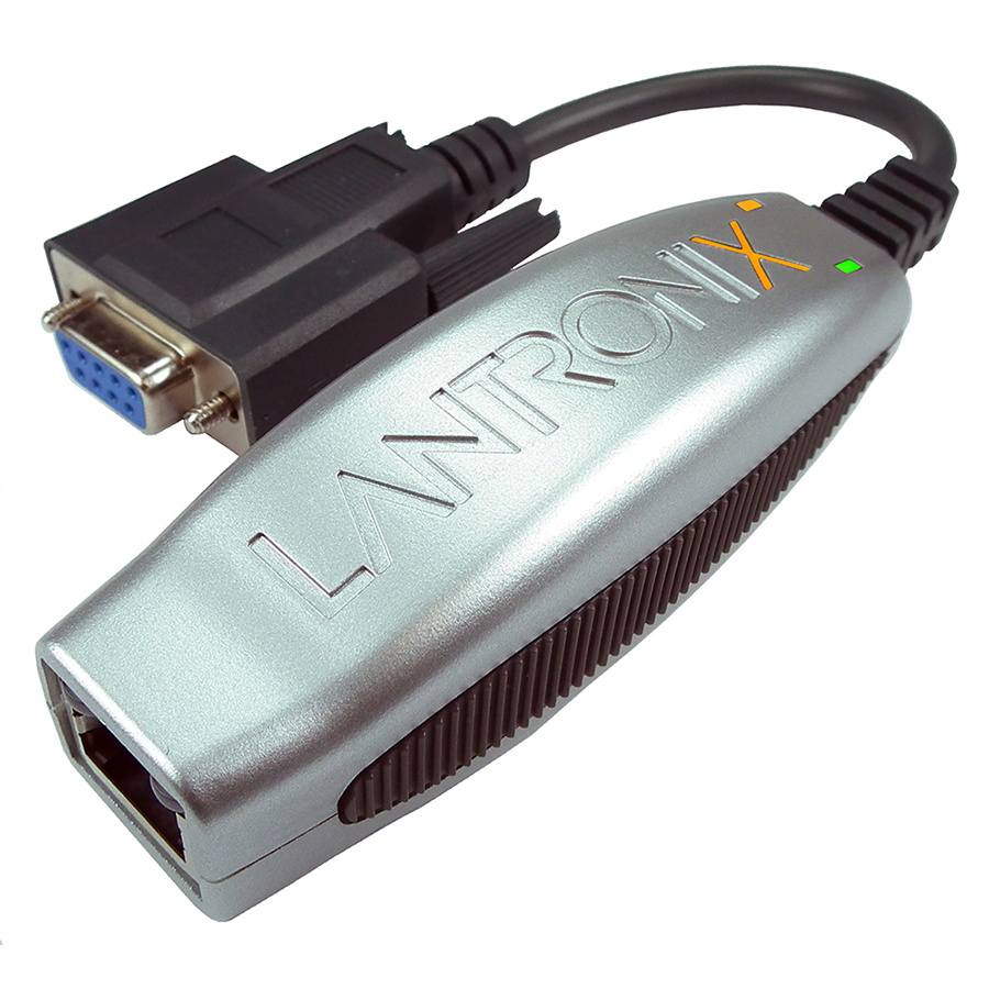

You’ll see from my code example that my COM Port is COM11 - it isn’t a local port. It’s actually a virtual port, created by a Lantronix Serial-Ethernet Adapter:
There is a free piece of software on them website called CPR (COM Port Redirector). It receives data on a virtual local port on a PC, and then directs it over the network to the device shown above which connects to the physical serial device. It’s worked great since I put it in, and means that a serial device can be accessed anywhere in the world. I believe you could have multiple PCs with the software installed, all accessing the same device. It opens a connection, makes the request, then closes it out again.
