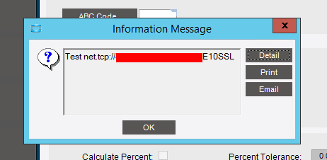

this.Session.AppServerURL should work within a BPM
Really!!! this.Session with no casting… lol, boy do I feel silly
I can make it harder if you want but I might get lynched :wink:
Let me know if you have issues with it. There are a few advanced gymnastics in there possible when we will need that in the core app. Still waiting to see if people stumble into them in the wild :wink:
It seems the AppServerURL var is empty :frowning:
Really wishing my IT would get me access to remote debugging already :cry:
Works for Me @Chris_Conn
What Method are you running this on? Mine works fine
Running this on a data directive for SYS_TASK table - alerts me by email when MRP starts/stops
String serv = this.Session.AppServerURL ;

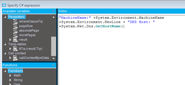

Oh! If you just need the machine name?
System.Environment.MachineName
or
System.Net.Dns.GetHostName()
