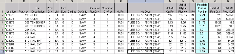

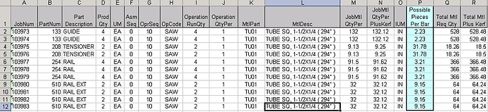

Yes, I’m probably missing something - or could it depend on environment? In this case - multiple partnums, with low run qtys? Ref sample spreadsheet below - is a list of a typical grouping of jobs related to one raw material. These are all of the finished parts will be used for a single sales order - i.e. on one piece of capital equipment. Where I’m not sure how to apply a possible of pieces from a bar as a BOM amount?
