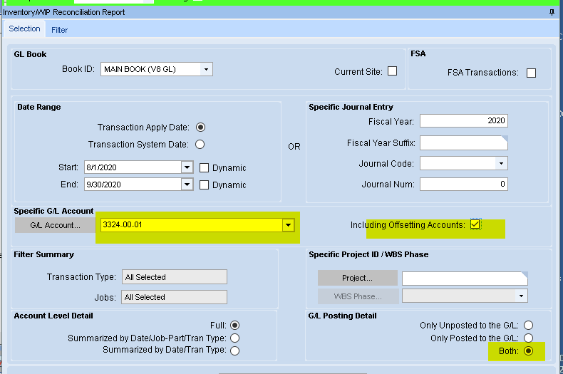

Run the INV/WIP Recon report, for the GL acct in question, with the “Include Offset Accounts” option selected.
I’d set the date range to the beginning of time (when you went live).
At the end of the report you’ll see all the transactions that went to this GL acct, including the offsetting trans.

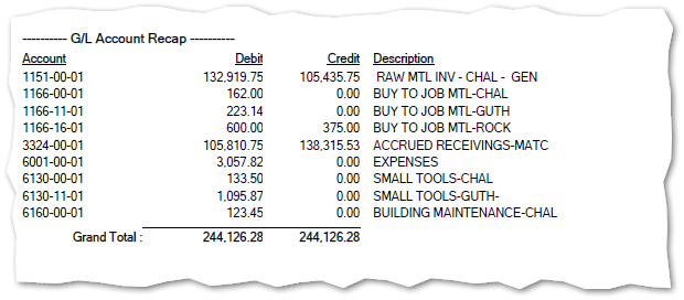

In my example (which is of a Test Company, and not since the beginning of time) , there are about $33K more credits than debits to our Accrued Receivings acct (which is poorly named)
