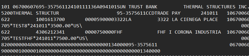

Has anyone experienced a problem with only 1 of 2 payments printing to the NACHA file? Both payments exist on the Remittance Advice, Positive Pay, & the Supplier Tracker payment history. The NACHA file appears to only have the first payment in the series for each vendor on my test payments. I have searched Comp Config, Electronic Interface, Currency Mast. I do not see anything to indicate that i need to tell Epicor to print all payments in the Group. I believe the file that my programmer might have a glitch. Has this happened to anyone???
Is it combining multiple payments to a vendor into a single payment for each vendor?
No. I created 6 test invoices. Two vendors had one invoice - they’re correct. The other 2 vendors had two invoices each. My NACHA file created the total from the first invoice of two for each vendor (not the total payment for that vendor, just invoice #1). However, the Remittance Advice prints the total correctly.

That is standard in the NACHA file format. The total dollar is in the file and one invoice number. The rest are printed on the remittance report.
Here is a KB
Any workaround with this issue? I got into same problem while try to generate ACH file for vendor with multi invoices in a payment. only the first invoice shows in the ACH file.
The remit report shows them. It is a correct ACH file.

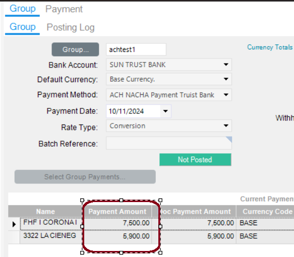

NACHA file is not correct. see the invoice amounts in the AP payment.
These are the payments
Oh, got it.
