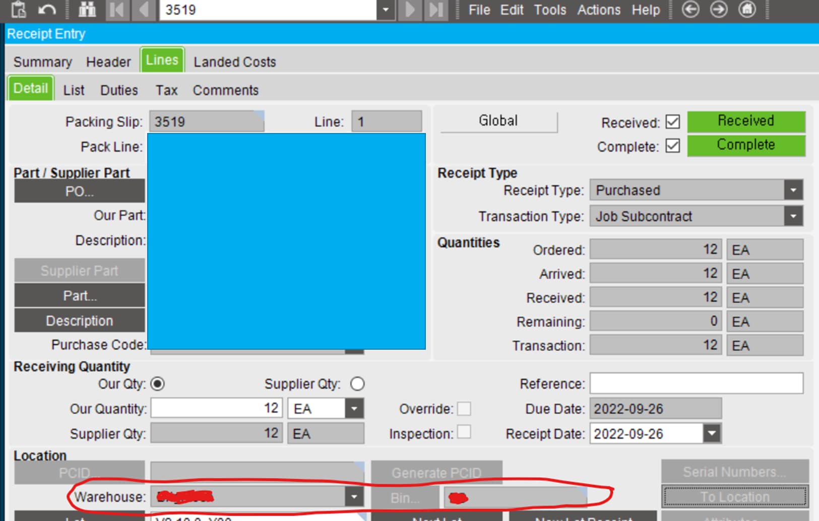

Hello everyone,
In Receipt Entry, when the type is Job Subcontract, the Warehouse/Bin field is disabled. This Warehouse/Bin seems to come from Part Maintenance.
But we do need to change this warehouse/bin from time to time.
Can’t I enable this field to be filled in manually?
Or can it be changed at the PO Entry stage?
Thank you in advance!
Subcontract is like Job Material on a PO. All the costs are going back to that job. That is why there is no warehouse involved. Once the parts are returned to the job in Receipt Entry, you then receive the parts from the job to the warehouse.
