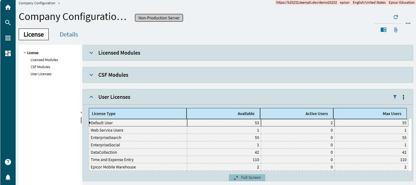

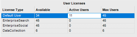

Is this information kept in a log/table anywhere?
dcamlin
(David Camlin)
2
There used to be a User Tracker that gave some detail… but they must have done away with it. I don’t see it in my environment anymore.
No.

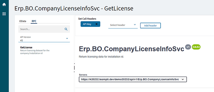

You can see it on the Company Configurator Tracker.

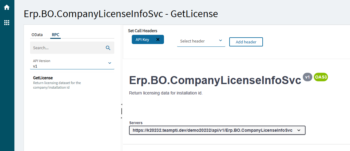

And if it’s on a tracker, you should also be able to get it from REST.
Also, the same Business Object is available in Directives and Functions…
