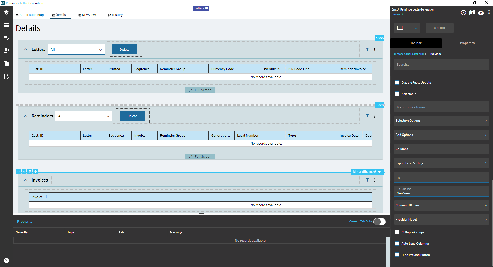

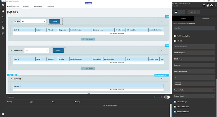

Hoping for a little help here. I’ve added a new panel grid to the Reminder letter Details for the invoice.

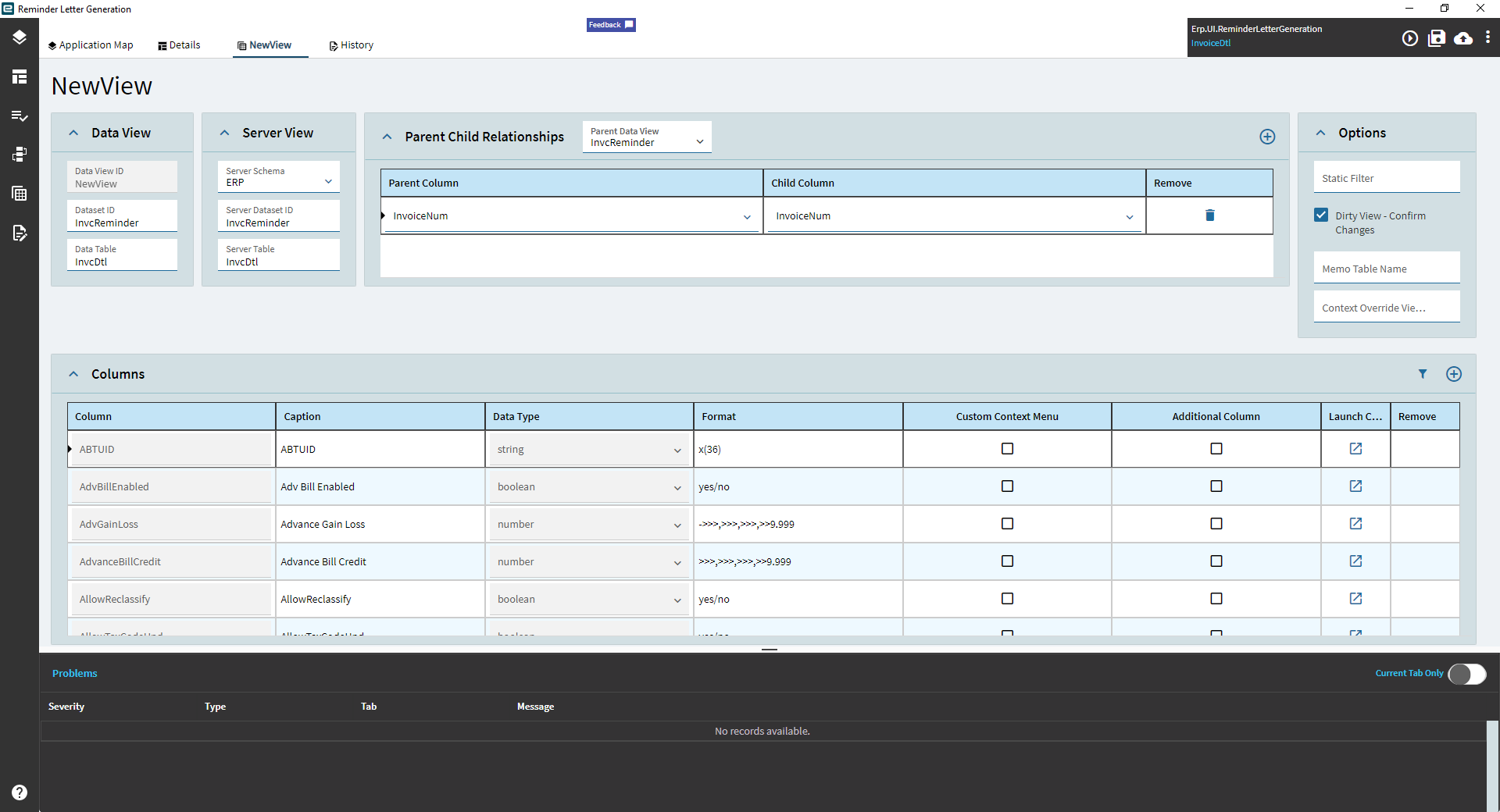

Created a new data view with the relationship for InvcReminder and InvcDtl Table with parent child relationship using the invoiceNum. .
added it as an epibinding feels like everywhere and then removed it everywhere during troubleshooting.
Why isn’t it returning any rows?
What am I missing? Do I need to create an event?

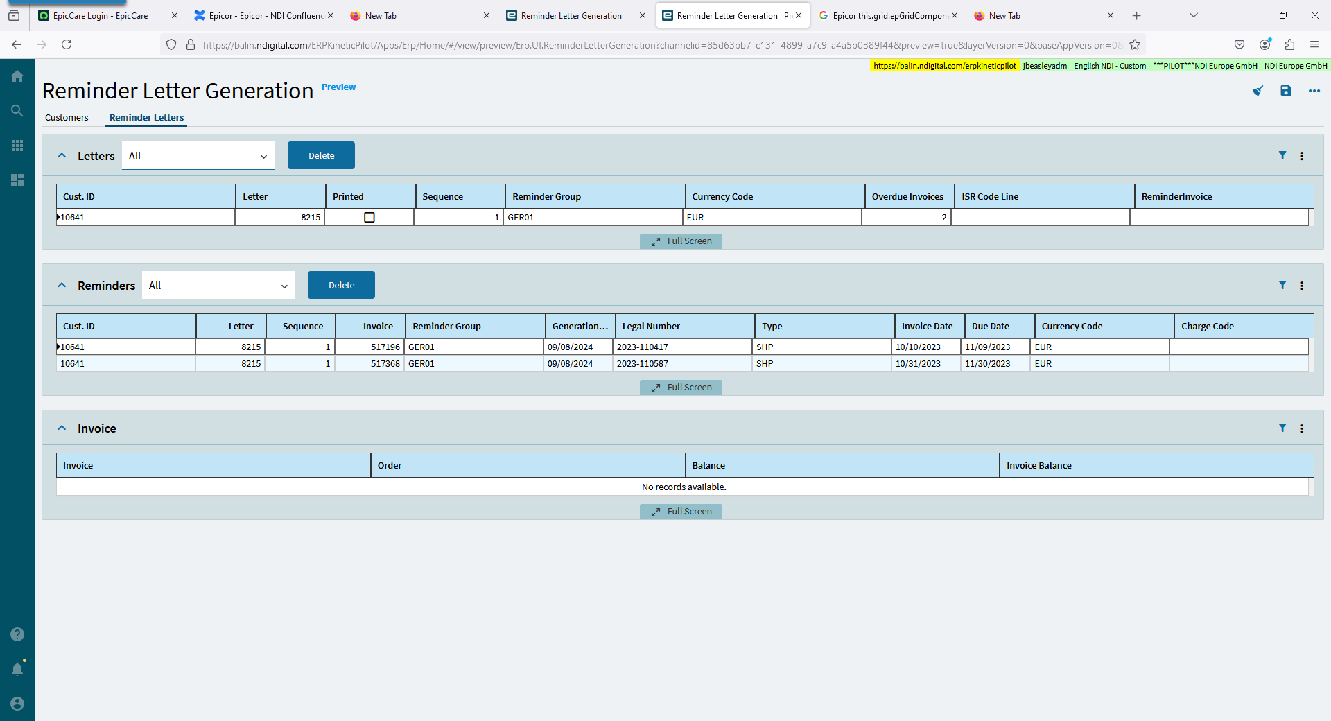

I’m familiar with the debugger. It doesn’t look to me like the event is triggering.

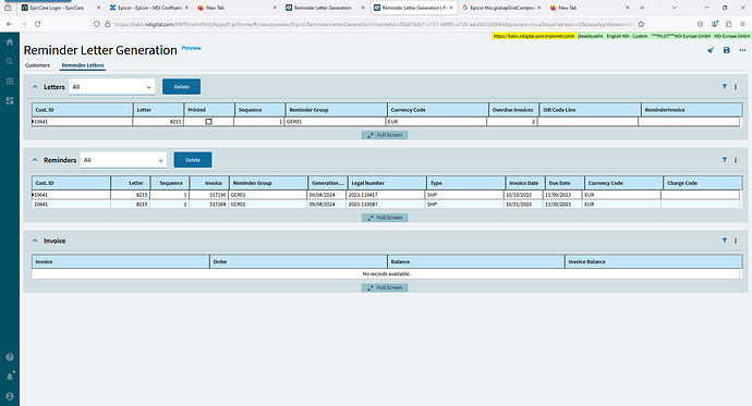

This is what I’m seeing.

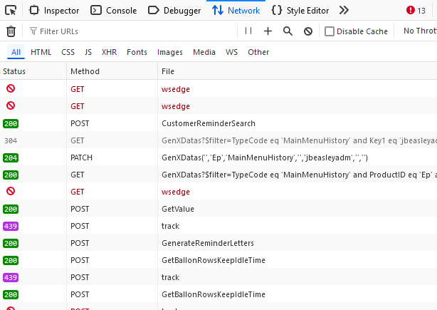

Network
Errors and warnings
There isn’t an error just nothing being returned
Thank you for your support!
Hit Ctrl+Alt+8 in Kinetic to enable console debugging to see the events firing in the Console.
The Network tab is useful to see what REST methods are getting called - it looks like CustomerReminderSearch and GenerateReminderLetters are called to populate the other grids. You can click on them to get some more information (how the method was called, what the response looks like, etc.)

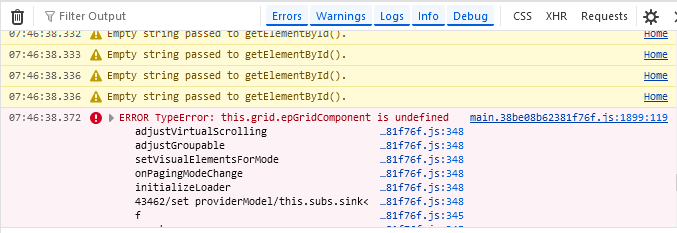

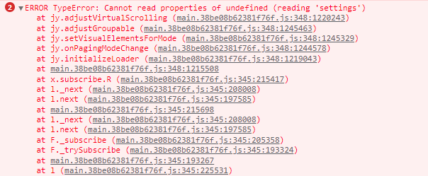

This is the error I get from the console
But I get the exact same error on the form without the customization.
So I’m not sure. I’ve created a case with EpicCare. I hope that they support.
