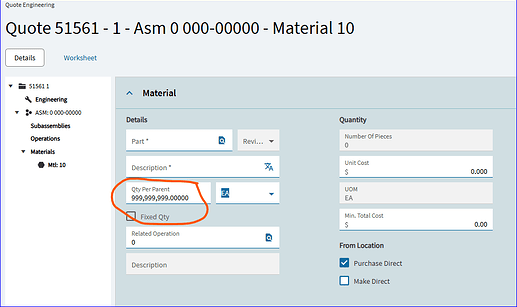

I tried to use Quote line Engineering to add a material line item for the Ink part and I can see I am only allowed to enter 7 characters before the decimal point. It seems a limitation of maximum quantity is set.

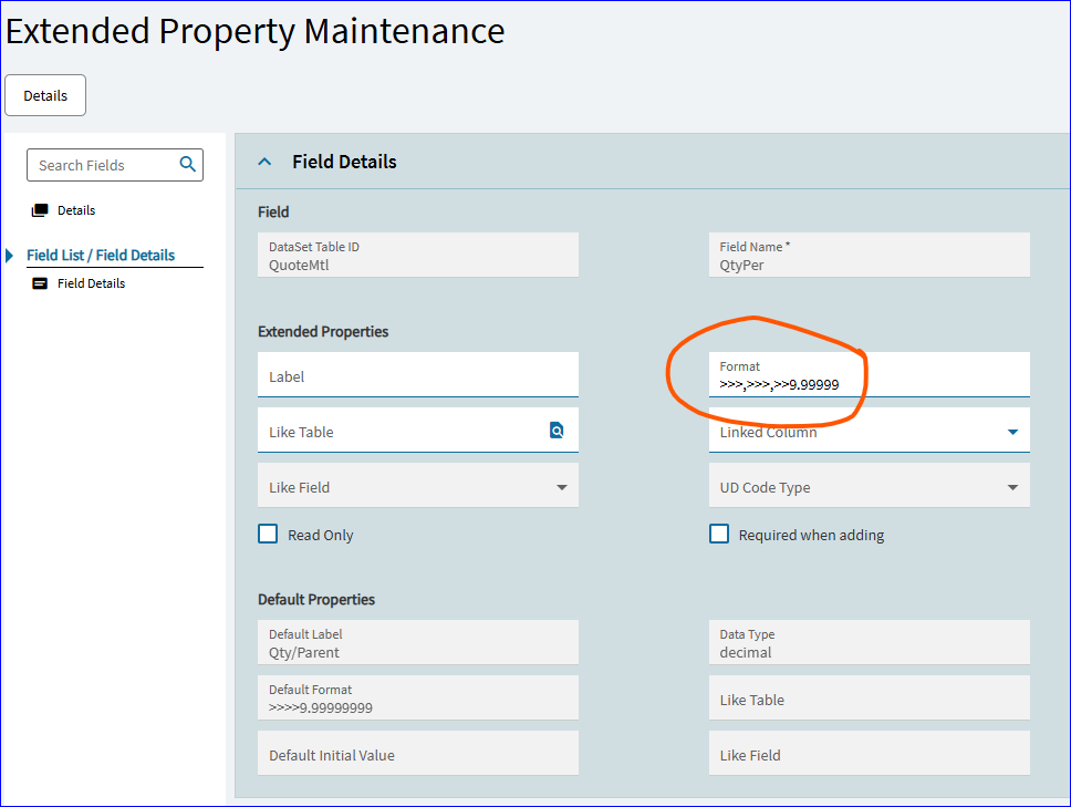

The default format for QuoteMtl.QtyPer is >>>>9.99999999
Change that in Extended Properties:

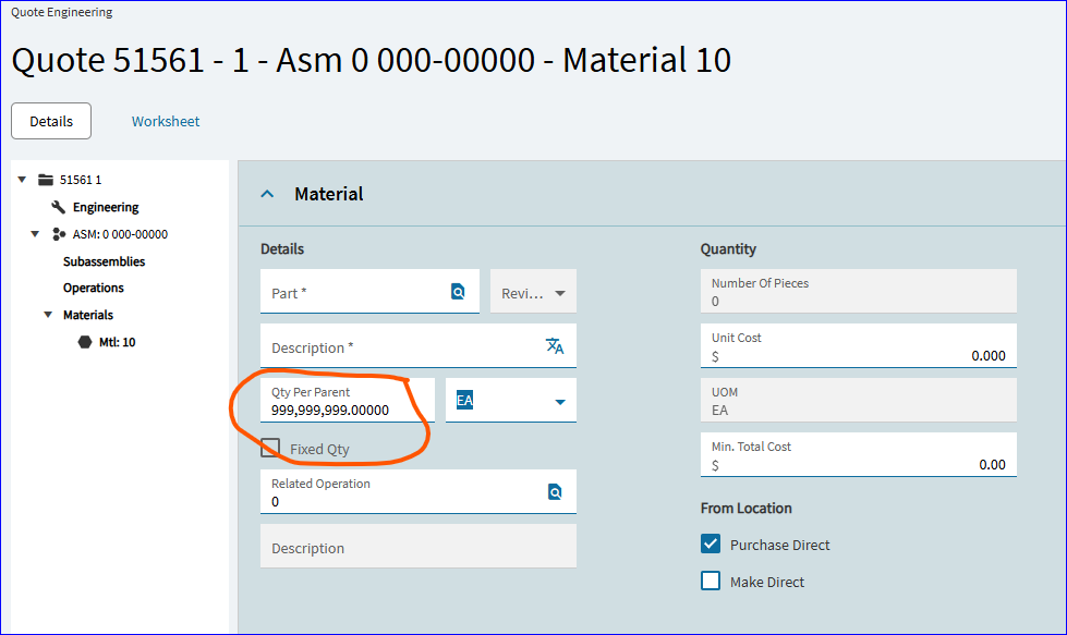

Quote Engineering honors the change:
You’ll just have to make sure the math works as expected on the other end.

Thanks so very much this was exactly what I needed, however being the patient individual I am I should have reviewed the error message more closely. It was a field named “ReqRefDes” that needed to be extended. I used the same steps above to also extend this field and it works now!
