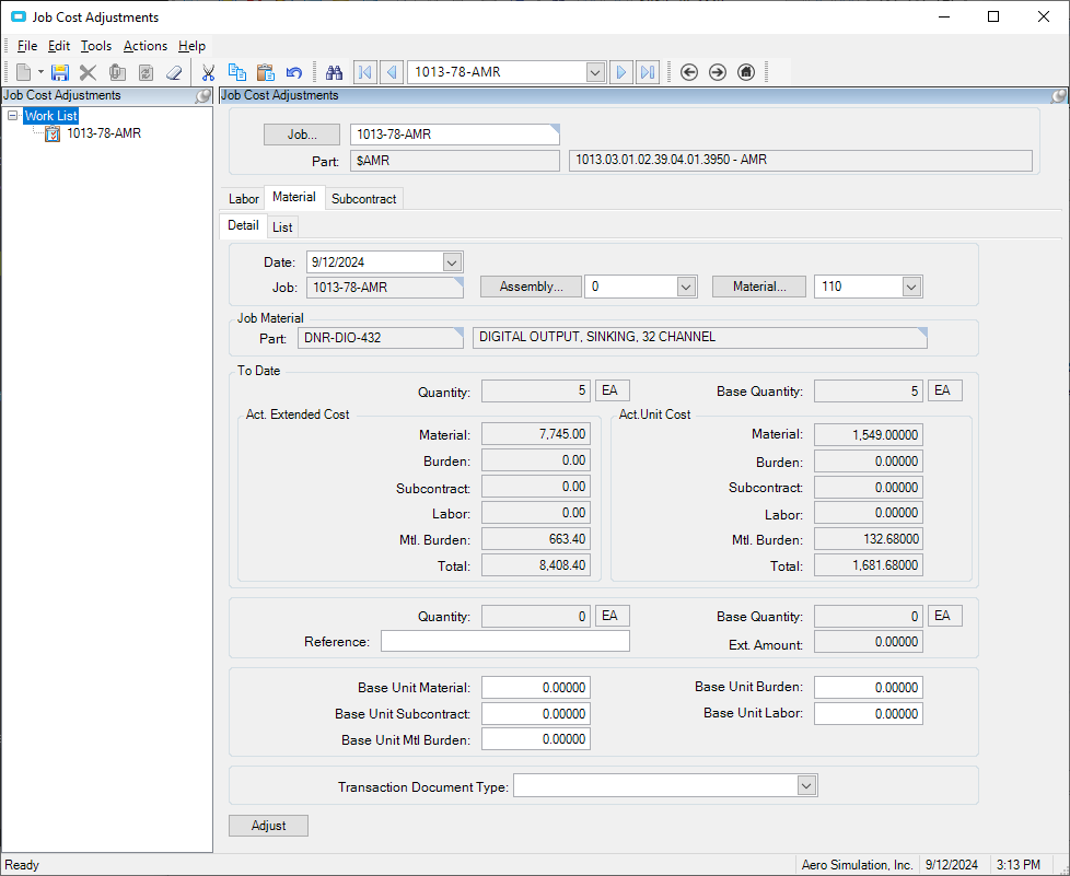

When I try to do a job cost adjustment to take the parts off the job the Quantity field is grayed out and I can’t tell it to remove 5 from the job. I know I can do the Quantity Adjustment to put the 5 into inventory and put the serial numbers on then.
What am I missing to get the 5 off the job so that after the 5 are properly in inventory I can issue them to the job with the serial numbers?

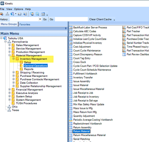

Hi Jeanne,
Use the return material program here to put it into inventory and then do your qty adjust out/ switch serial number on part / qty adjust in with assignment of serial number / issue to job with serial number from inventory.
