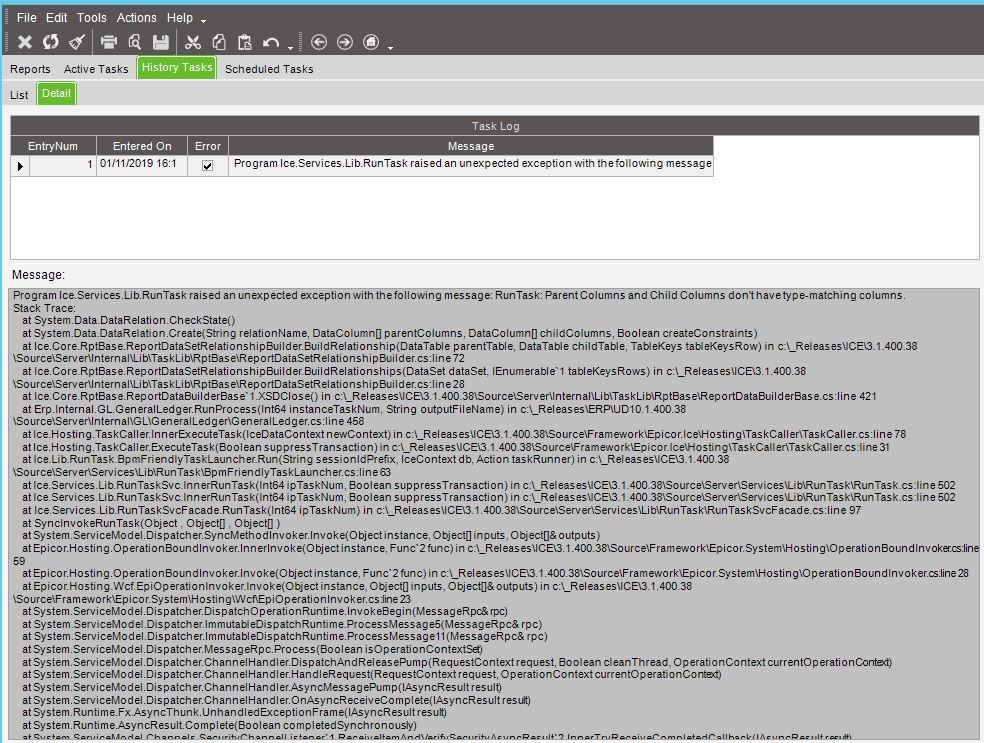

Hi Calvin,
i tried your method, however i get the error message while running the new RDD.
i think it it because it had conflict with table relationship “Detail2OneTimeGLDetail” as it had the same relationship field with “TranGLCtoDetail”
One thing I’d do is make the Table Relationship have a type of Output. This will make sure it gets the original records even when a matching record cannot be found in TranGLC.
Hi Calvin,
attached is my setup of RDD for your kind perusal. i have set accordingly based on your advice,
however i still get the error messages. Thanks.
