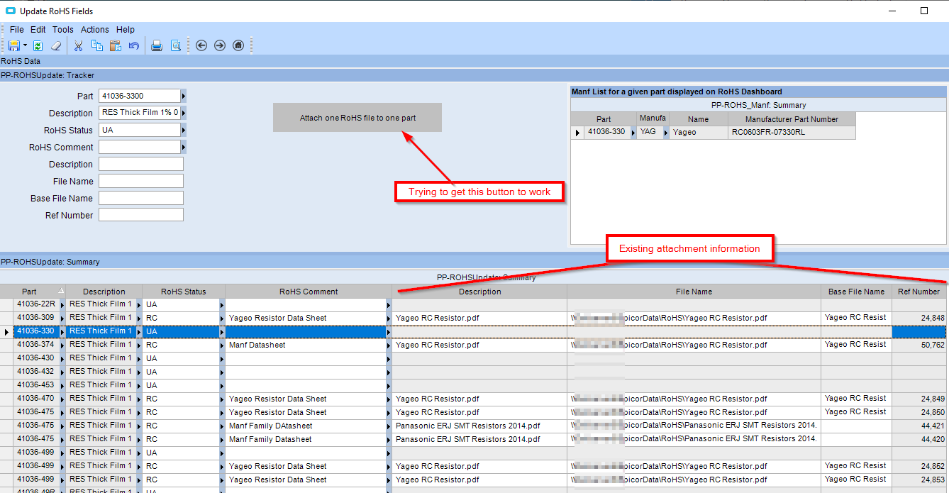

I have a deployed dashboard assembly that I would like to customize to add a button that allows a file to be attached to the Part record. Tracing the New Attachment process scared me off, until I came across Jose’s one line of code to attach a file:
https://www.epiusers.help/t/code-from-meug-presentation-on-5-20-2020-customization-tips-and-tricks/67376
But, it doesn’t work for me. I created a button on the tracker view, I think I captured the dataview of one selected row. I have AttachmentHandler.DropNewAttachment in code and it does not generate an error. But, it does not create the attachment on the Part record as I hoped.
Perhaps this simple one line code does not work with Dashboards, only in out-of-box forms?
Or perhaps I need to more directly indicate that it is the Part record that I want to attach the file to (and the “ROHS” Document Type ID if possible)?
We do not have any 3rd party document software, and we don’t use Sharepoint, just basic Epicor functionality pointing to Windows File System documents.
Here’s my Dashboard:
Here’s my code:
