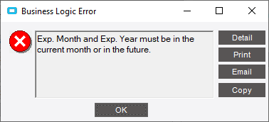

We have a user that would like to add an attachment to a Credit Card order that is closed. However, the card is now expired and won’t let us add the attachment.
Anyone know any workarounds to get this attached without having to update the card?

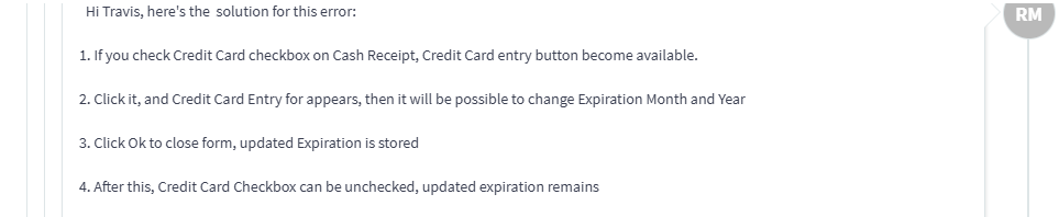

We ended up creating a case. The solution they provided is below. Instead of doing this, we just decided to attach it to the pack.
