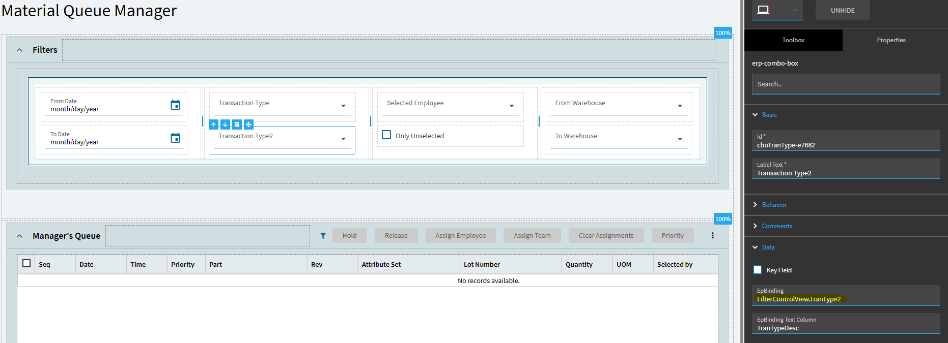

First, copy the Transaction Type combo box and paste in a second one.
Change the binding to something else (I just added a “2” at the end):

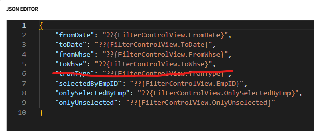

Now, go into the Grid’s Grid Model > Provider Model > Rest Params
Delete the tranType line… you’ll no longer be sending that through the rest parameters.

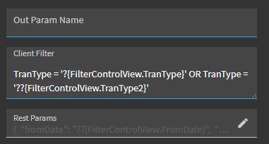

Now, just above the Rest Params… add a Client Filter:
TranType = '?{FilterControlView.TranType}' OR TranType = '??{FilterControlView.TranType2}'
The first filter is required… the second is optional (will run even if null).
You should be able to test this out at this point, but you’ll have to manually refresh the grid in the grid’s overflow menu.

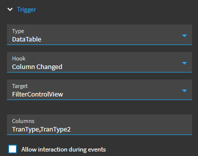

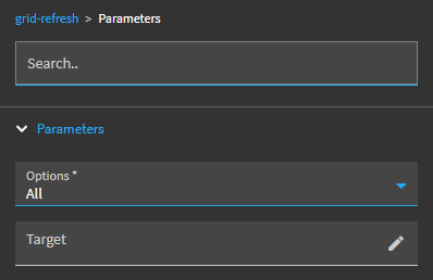

To refresh the grid automatically, you can add an event on Column Changes to the TranType & TranType2 columns:
