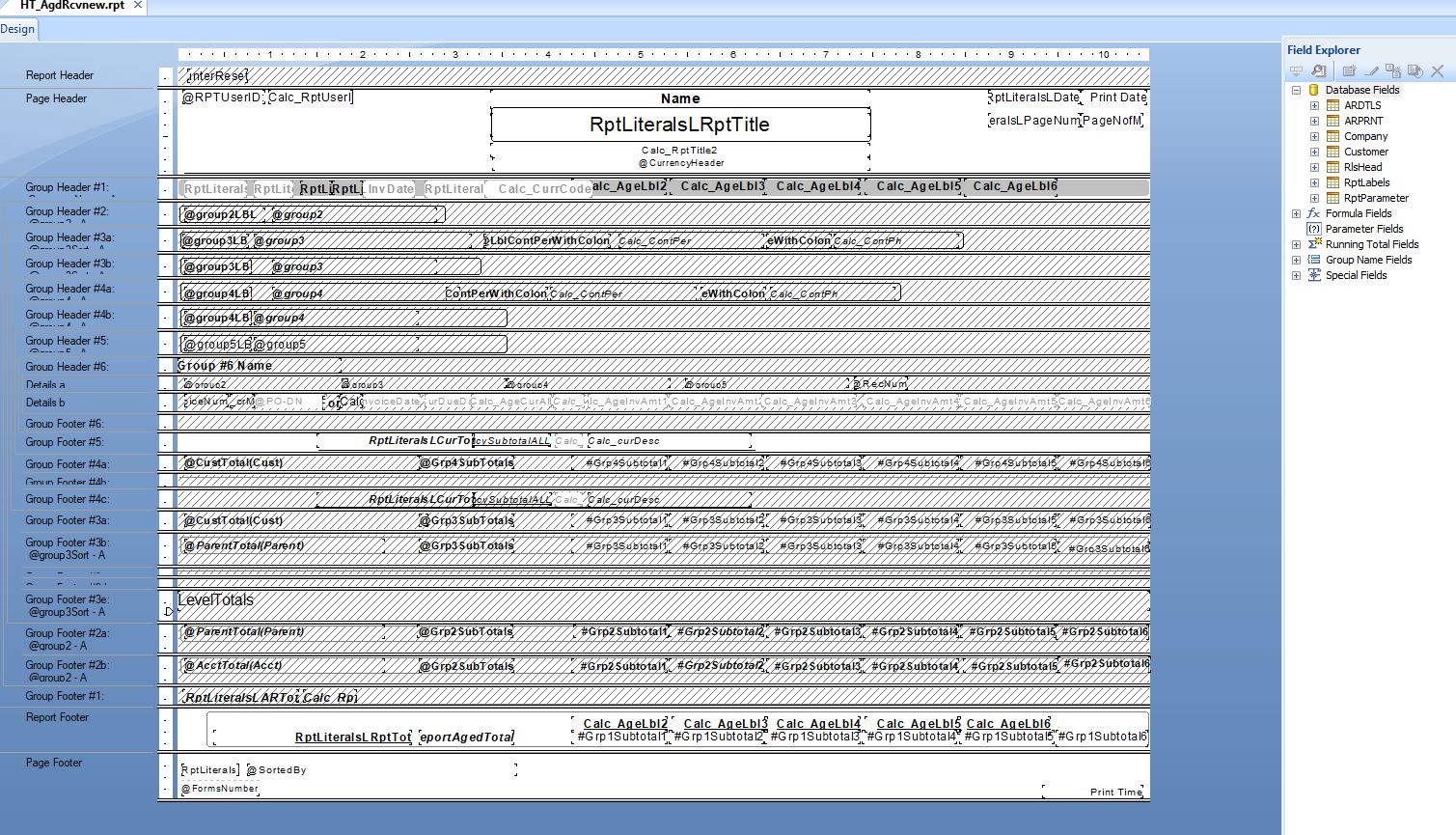

I am trying to add a column in the crystal report, I updated the data definition and the customer table is available but for the love of…I have no clue where to stick the field so it pulls over the customer terms. Anyone have a report or any idea on where to put the terms

After that I can use the Crystal Developer to edit the report.
- open the .rpt report file and launch the Database Expert from the menu
In Data sheet - Available Data Sources select the default connection (which can be tricky),
- edit the properties to specify your XML file as the active datasource
- then move the new table(s) over to the “Selected Tables” pane
In Links sheet - add joins as needed
After closing the database expert, the new table/fields should be listed in the Field Explorer - drag & drop into the report.
