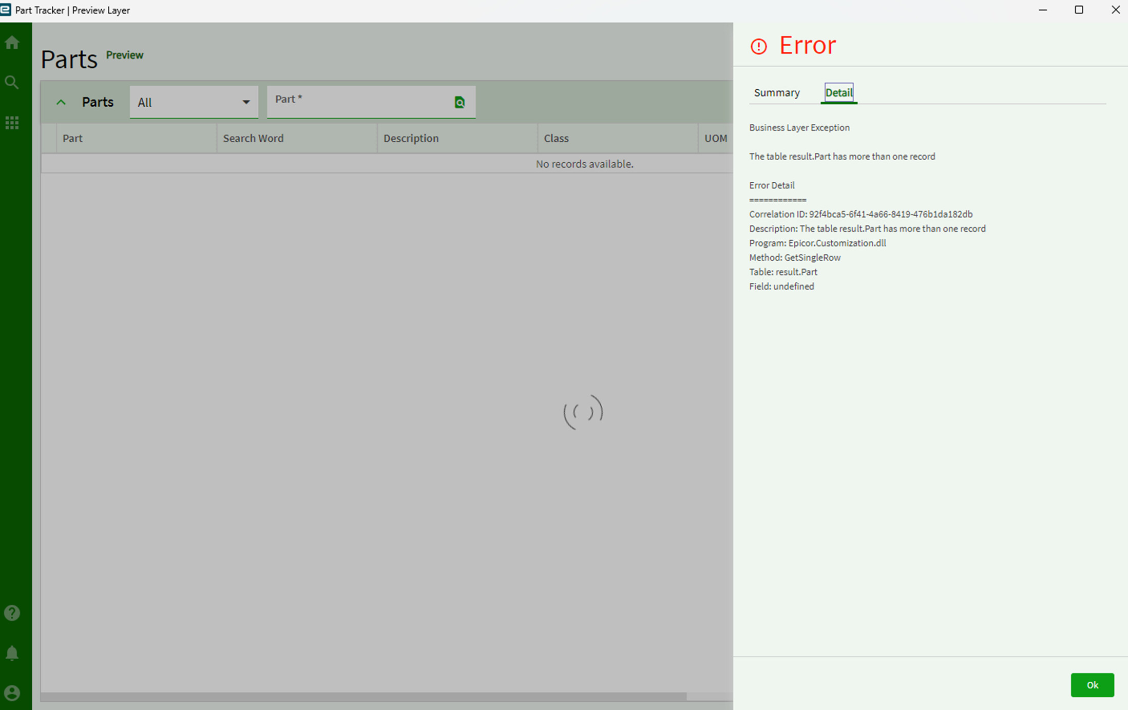

Kinetic, i did think about BPM and when i did it on the Landing page i was getting an error previously on the getrows method

That is what i thought but i cannot seem to get it to work. Oh well.

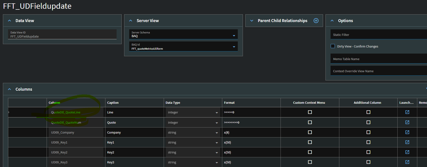

  1. Create another dataview in a new layer populated by a baq that contains the field you want and the fields you need to make it unique ( customer and part number to get custpart?) Have it have the “key fields” as parameters.
  2. create an event " after - on load" for the specific form you would like to display the xref part number and use a kinetic baq to populate the dataview
  3. create a field in the layer bound to the field in your dataview you would like to show

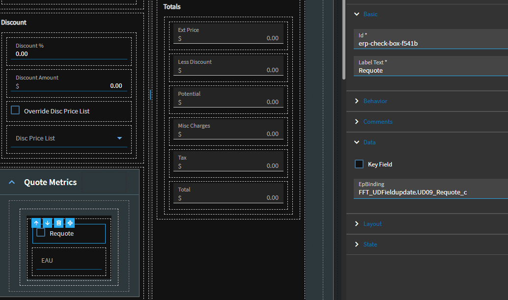

Form:
Dataview (key fields in green):
