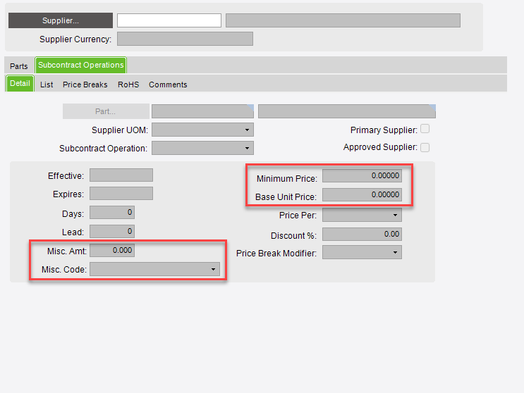

That functionality exists on the Supplier Price List.
Can you make a snapshot of the field?
I’m going with the assumption that you are talking about subcontract operations.
You have two options depending on your specific situation. You could put a miscellaneous charge on the part that would get added to the PO every time one was created. Or you can put a minimum price ($500) and the per part price (.014) and the PO will be created for $500 until you hit 35,715 quantity that will drive it over $500.
