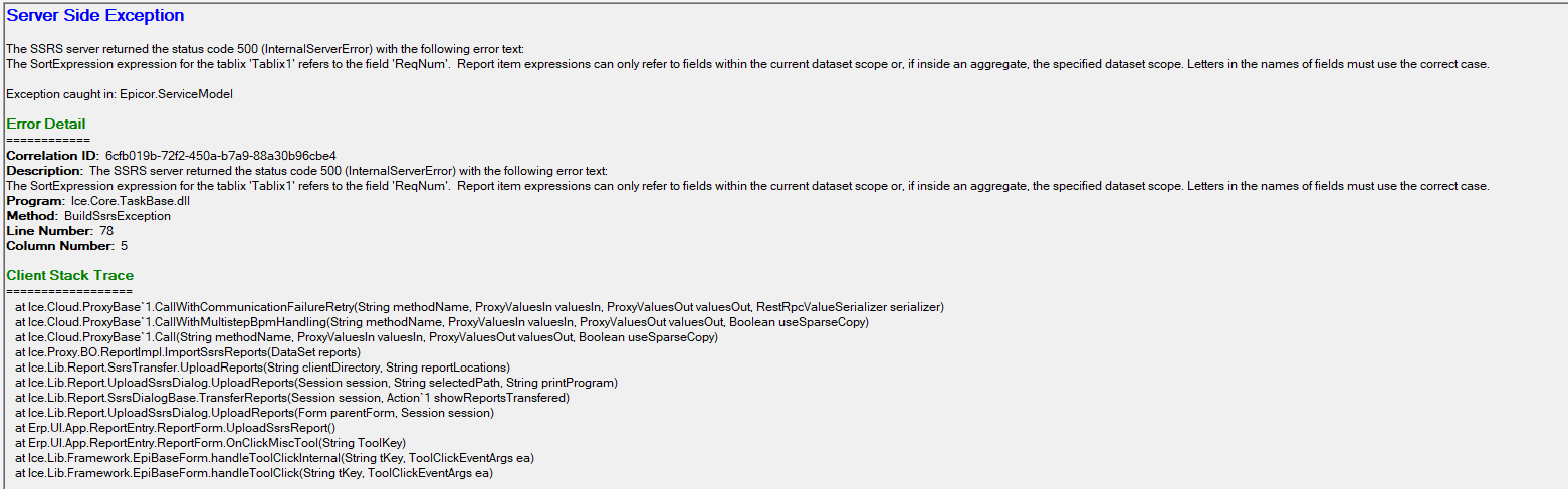

I am customizing a PR report to add label On hand qty but after edit the report there’s an error

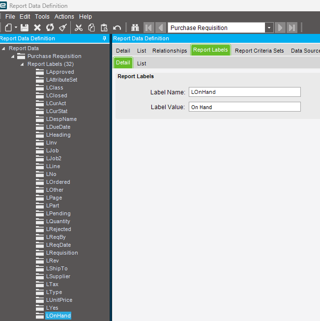

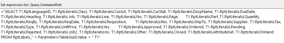

It Looks like the error is referencing a field called ReqNum. Check the Report Data definition to make sure that field has not been Exluded. Then check the SSRS Select statement to make sure ReqNum is still in the select statement and lastly make sure that there is a Field called ReqNum.

You can add labels to the RDL without adjusting the RDD. Are you adding a new field along with the label?
hey @DaveOlender yeah I already checked, eventually I customize the original report again and it worked, thanks for the help
