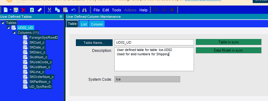

Am I missing a step here somewhere? I am making the UD table/fields using UD Column Maintenance. I am adding my needed fields but I don’t have the fields Key 1, 2, 3, etc. Here is my UD table for the skid numbers and the corresponding data to go into it. Do I need to do something more?

UDxx tables come with Key1-5 and Characterxx, ShortCharxx, Numberxx and Datexx like in the E9 or before days.
You are adding UD fields to a UD table those fields will show in a view, but not in the UD Columns as they are system fields.

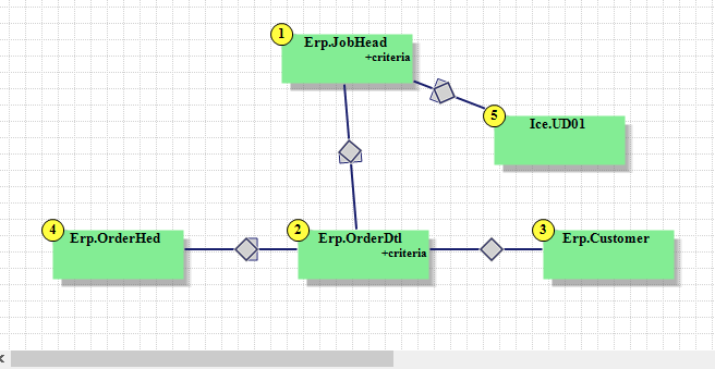

I’m back working on this again. I have my UD table with all my added fields but I’m unsure how to link it in my BAQ. Currently the UD table is empty, no data in any of the fields. I want to link this to my JobHead table in my BAQ, specifically I want to link it to the JobNum and JobCode fields but if those fields are empty in my UD01 table I’m not sure how they will link.
Here’s what my BAQ looks like for the labels report. My hope was to take the data from JobHead and OrderDtl and populate the corresponding fields in my UD01 table.

If the UD01 data is related to the job then I would do something like Key1 = ‘SKIDDATA’ and Key2 = JobNum. Key3-5 = “”
Then the join is Company and Key2 = JobNum. Criteria is Key1= ‘SKIDDATA’
