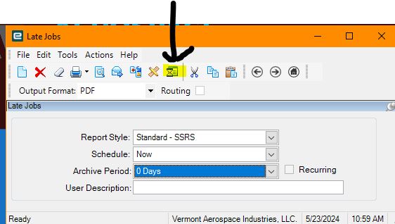

I am needing to add a report to an existing process set. However, under File, it doesn’t allow me to add anything; just add a new process set.
When you run the report you can choose to add it to a process set. Use this button.

I am assuming that whatever parameters I set will be the parameters that get saved to the process set, correct?
Yes, and when you look at the tasks in System Agent, I think you can review the parameters.
