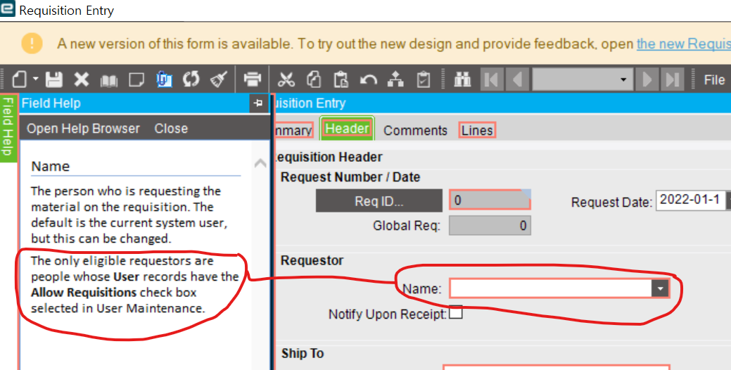

Hello everyone.

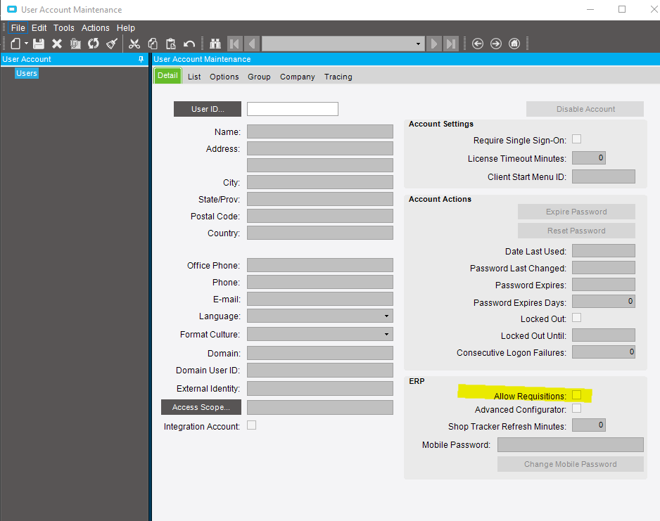

I want to add requestor. In Epicor Field Help, it says there is a field to check in User Maintenance, but I can’t find it. Where is this field?
Thank you in advance.

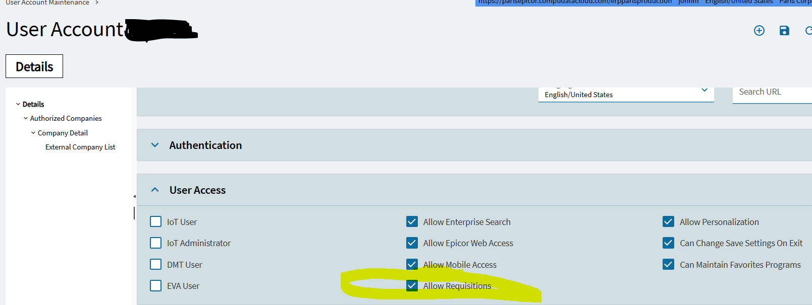

The Allow Requisitions checkbox is in User Account Security Maintenance to the bottom-right of the main Detail tab.

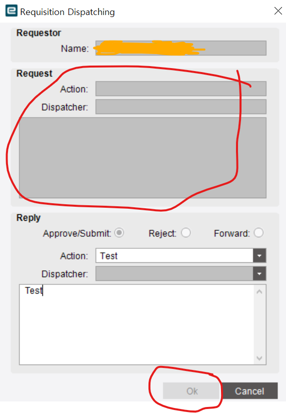

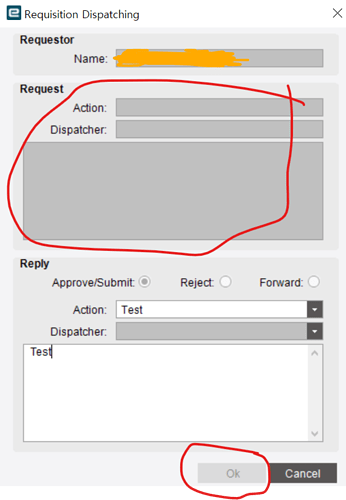

With your help the requestor has registered. And then i’m trying to do the dispatch requisition after completing the requisition entry, but the field is not activated.
  1. Do I need to set something else?
  2. Can’t we just do the Generate Suggestion work without this dispatch requisition work?

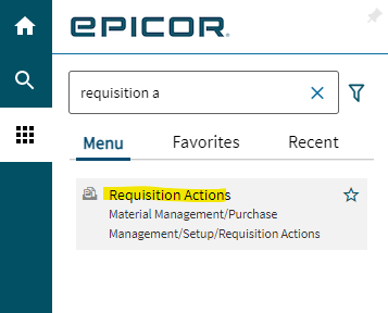

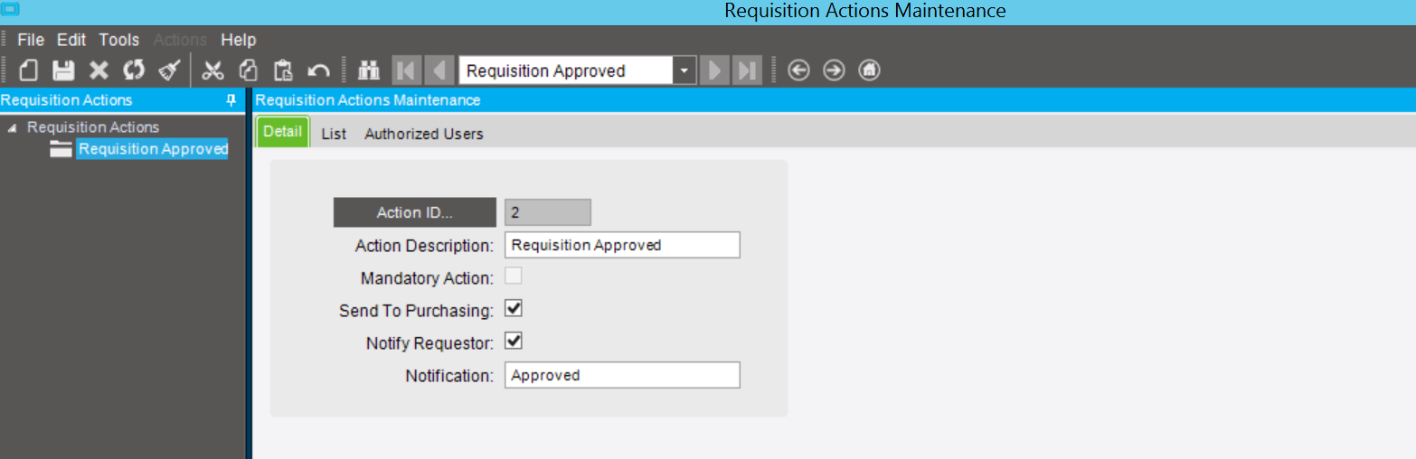

Need to setup requisition actions in purchase management -->setup–>Requisition actions.
Thank you. It was solved because of your advice.

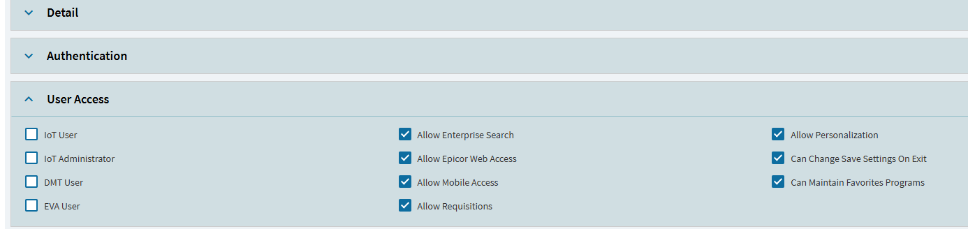

Where is this in Kinetic? Thanks.
Which part?
Requisition Actions?

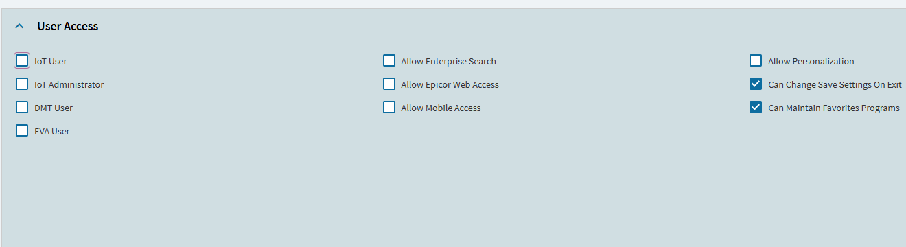

User Account Maintenance >> User Access
How do I get that option to appear?

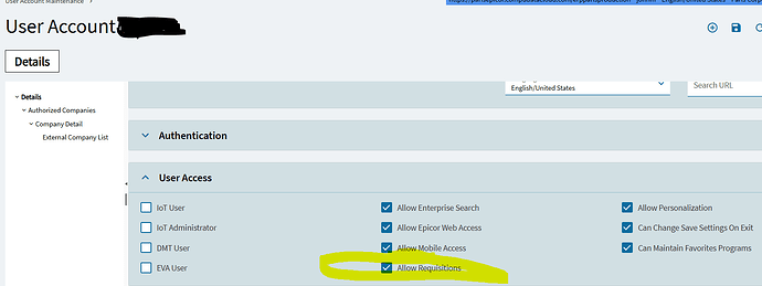

Good question…my screenshot is Kinetic browser 2023.2.11.

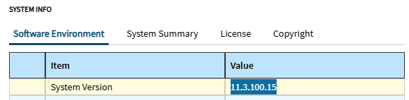

I believe I’m on 24.1.15
Must have been moved with 2024 I guess…sorry I can’t help.
I don’t know what happened but the option has appeared now. Glad I have the previous screen shot to know I’m not totally crazy.
