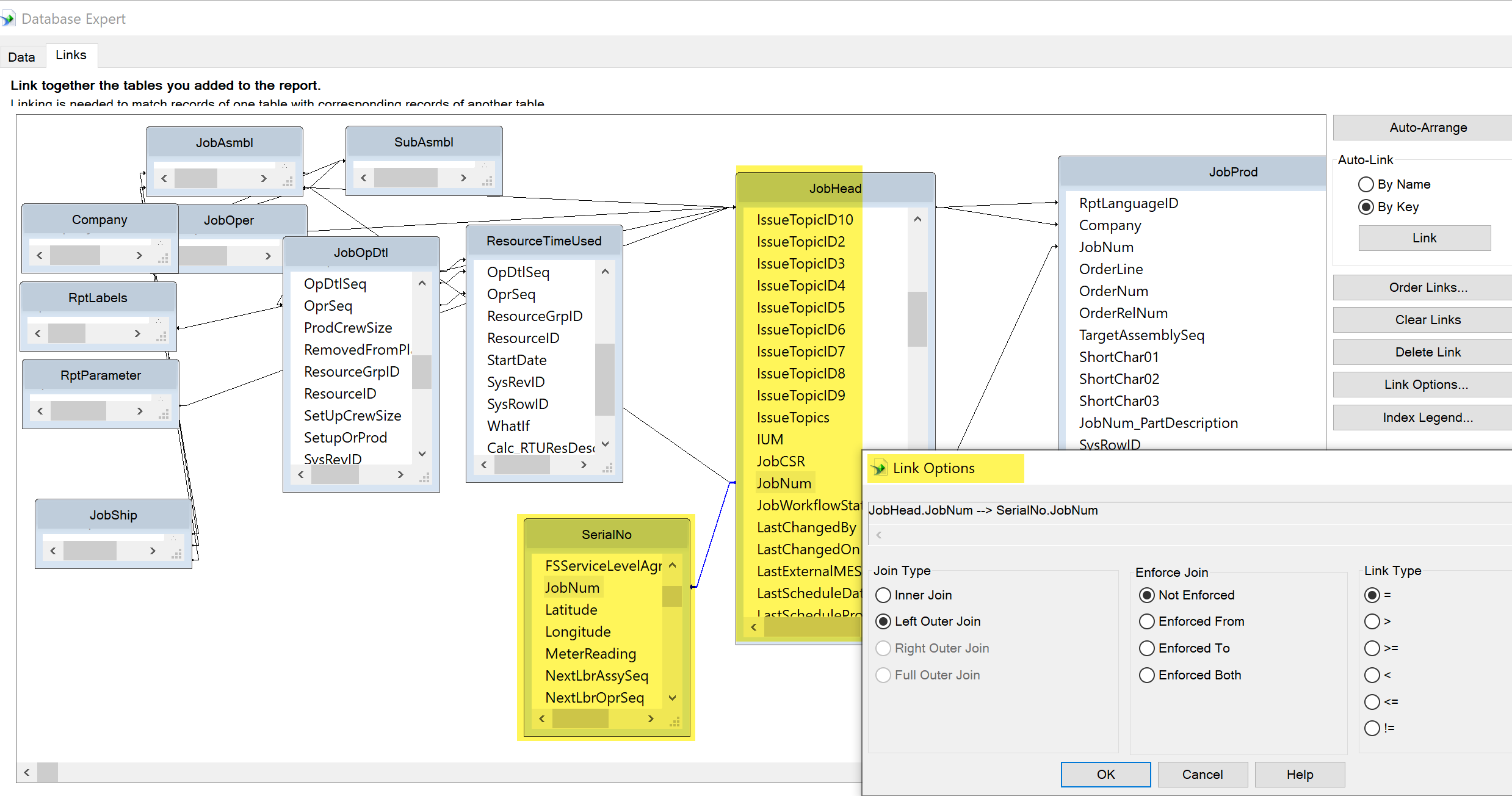

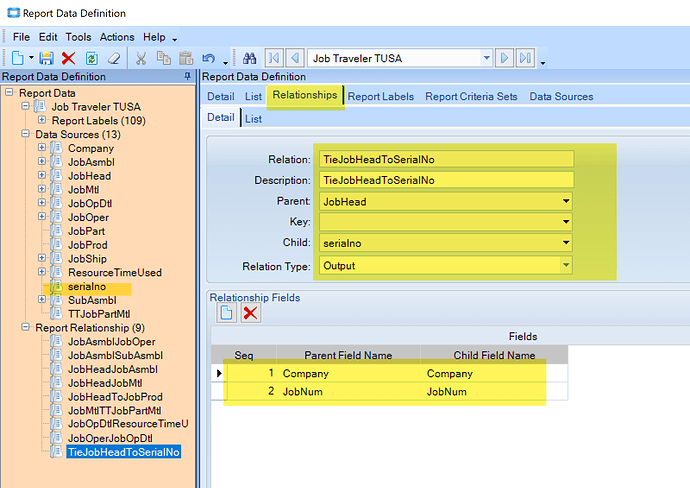

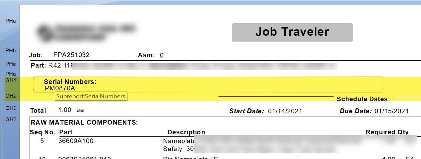

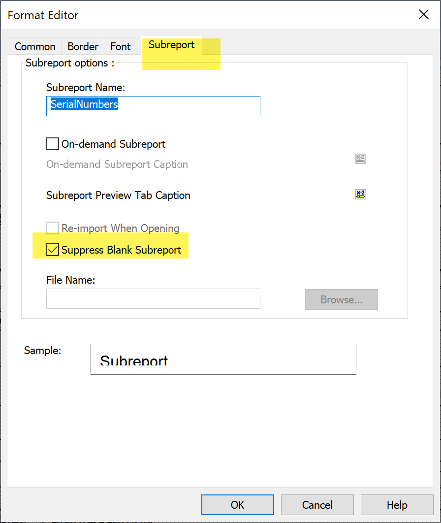

Hi Dylan,
We have serial numbers on top level job part number. We do not get duplicates for jobs producing many serialized parts. Here’s the setup, in case it may be useful to you, first in Epicor, second in Crystal. I’m sorry to say it’s in Crystal… I only go kicking and screaming to SSRS as needed :rofl:
Nancy
