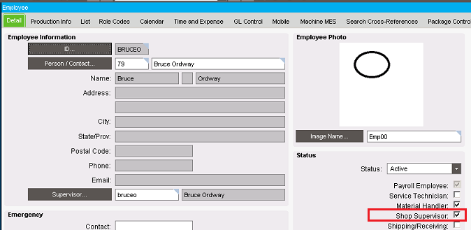

Hey Bruce. Thanks for the reply! They do have shop supervisor checked but still aren’t appearing on that list. Any other suggestions? Our Epicor is pretty old and buggy so I’m thinking that may be it - it’s 10.0.700.4 if that helps
Do you have the Payroll module - and setup a Payroll Employee record?
I seem to remember needing both Shop and Payroll records before they’d be listed as a super.
