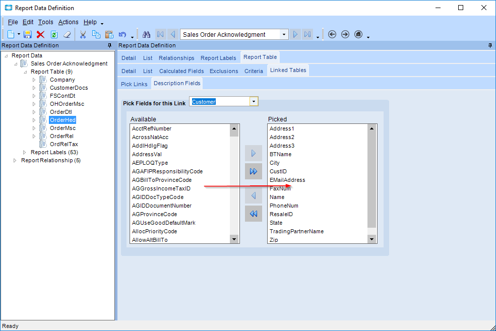

I am working on our Sales Order Acknowledgment in 10.2.300. It is customized a bit and I am running into an issue. The error keeps getting thrown Invalid Column Customer_SampleNew_c. So I see it is in the report correctly everywhere, but it is not in the RDD. Does it have to be? If so, how do I add it?
Thanks! I have been messing with this for a few days now thinking I ws going to have to rewrite the whole thing. But this will save me a bunch of time. It is something I only thought of today after I took a 2nd look. What can I say, I’m a little slow at times!
