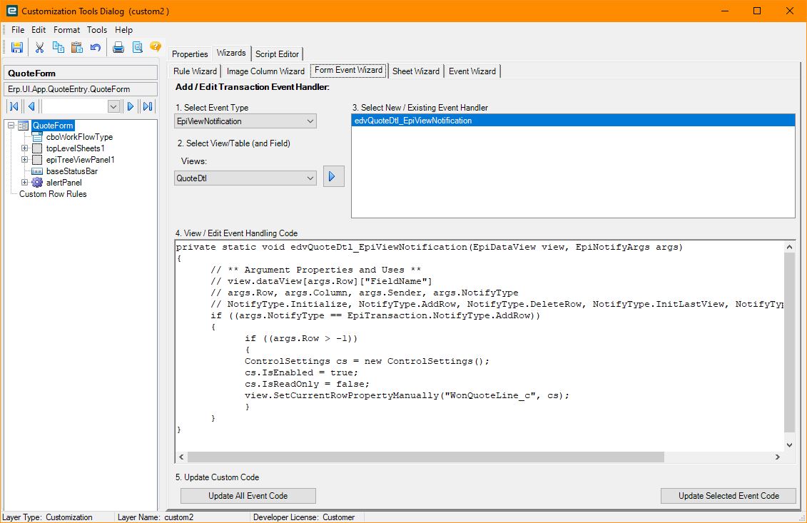

If you are using the classic client, I believe you can unlock fields in the data view as shown on this thread ```
It may work, depends on if update will let you do it vs updatext
Something like
private void edvQuoteDtl_EpiViewNotification(EpiDataView view, EpiNotifyArgs args)
// view.dataView[args.Row]["FieldName"]
// args.Row, args.Column, args.Sender, args.NotifyType
// NotifyType.Initialize, NotifyType.AddRow, NotifyType.DeleteRow, NotifyType.InitLastView, NotifyType.InitAndResetTreeNodes
if ((args.NotifyType == EpiTransaction.NotifyType.Initialize))
if ((args.Row > -1))
ControlSettings cs = new ControlSettings();
cs.IsEnabled = true;
cs.IsReadOnly = false;
view.SetCurrentRowPropertyManually("WonQuoteLine_c", cs);
Is there a custom assembly to include that enables ControlSettings?
Edit: Never mind. I had somehow set my customization to VB instead of C#.
Well this code didn’t throw any errors. But it also didn’t enable my field. Since my field is in a control and not in a grid, do I also have to update the control?
Did you run the Form Event wizard to wire in the event handler?
Did you try using EpiTransaction.NotifyType.Initialize instead of AddRow?
Gah! I didn’t notice that! Thank you!
Dang! Still no joy. The code compiles fine, and a messagebox shows it triggers fine, but the custom control only gets enabled when I uncheck the quoted checkbox. Since I use Initialize, I get the messagebox like 5 or 6 times when opening a quote. But if that quote has been “quoted” then my custom control remains disabled.
You could also try tieing the setting to the EpiViewNotification on QuoteHed. If that doesn’t work, sorry for pulling this in a different direction ![]()
Yea I couldn’t get it to enable my custom control. It really seems like this should have worked. I guess the Epimagic is just too strong!

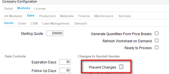

Not sure if you have a business rule to leave it on, but there is a setting in Company Configuration that you can set/unset to Prevent Changes to “Quoted” quotes. Maybe that’s turned on?
Yes, unfortunately for now I have to leave that on. Thanks for digging for me!
