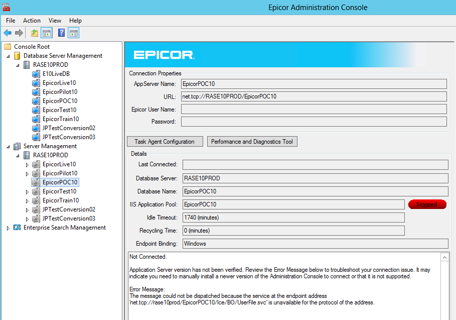

Attached is the current console display and I have stopped and started the IIS pool for the Epicor POC 10 but when i go select connect to application server i keep getting the same error.
I did find one mistake i made was the web site directory was wrong and needed to be pointed to the E drive and after another deployment i received the same error again.
I noticed your binding is Windows. Is that what your other application servers are using. Are you setup correctly to use that binding? You have plenty of available memory on this server, correct?
That is my fault its supposed to be “usernamewindowschannel” as the others are setup that way. And the server has 80GB of RAM. Sorry for the older confusing screenshot. I mocked up the new application server as the other existing servers that have worked for some time. There must be something small I am missing
I would triple check the username / password you have. If you can I would IISRESET or reboot the machine. Typically, I have found this error to be related to the user I specified.
Thanks ill check around.
Yep you were right it was user account credentials. Had to run appcmd.exe list apppool <<app_pool_name>> /text:* to find the IIS password for the pool.
