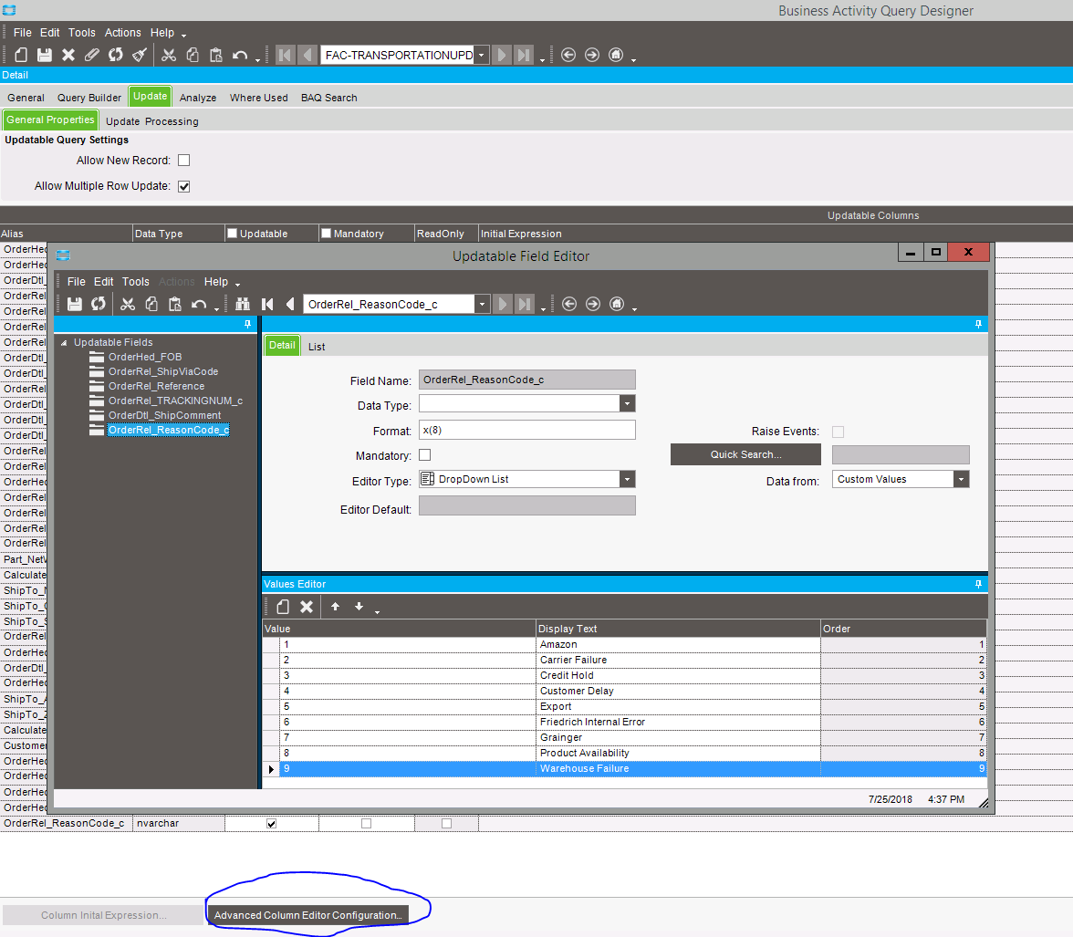

I was searching around all last week for a way to make a dropdown column in a BAQ and all I came across was people suggesting to use code. I stumbled across the Updatable Field Editor and was able to make a custom dropdown selection column for a dashboard.
I was wondering if anyone else uses this or if you don’t and why. I’m assuming if you know how to code it then its fairly simple but this might be useful for those who aren’t as savvy with coding.
First I added a UD field to my Order Release table and then added it to the form for display. Then I went to the baq designer and set it up as shown below. I had to edit the dashboard grid properties to show the field and then it started working as intended.
Where it says “Data from: Custom Values” - You can actually choose to get the column selections from a BAQ which I thought was pretty cool.
This only works with static lists. If you have dynamic data, you have use code.

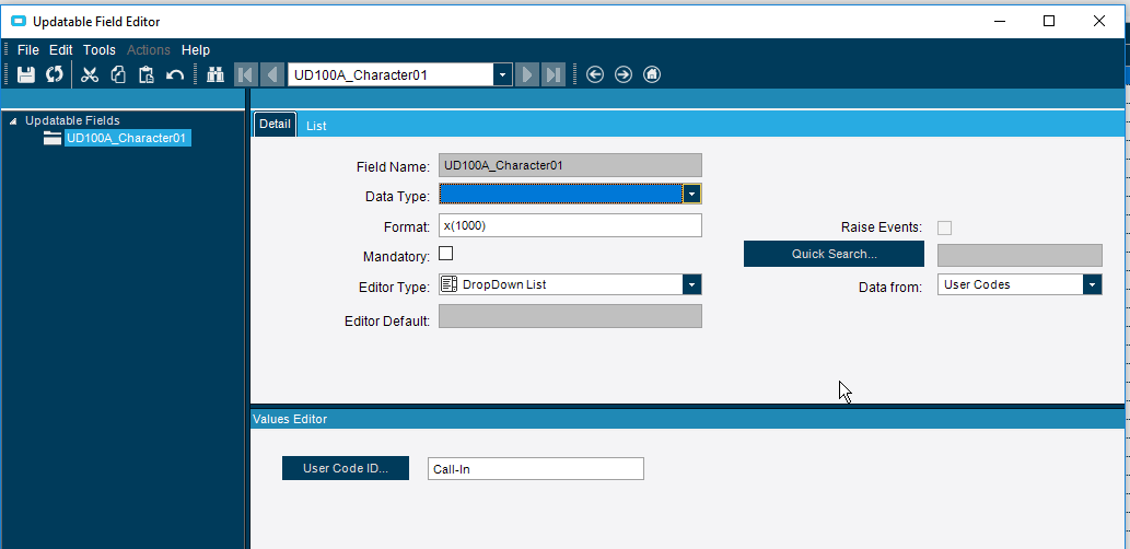

Not true, you can use user codes as well so you can make it dynamic (sort of). But you can maintain a list without code or going into the BAQ.

Yeah you are right to that level. But I think for most use cases a user code or BAQ suffices, and you can hand off list maintenance to the end user through user code maintenance. It’s kind of dynamic (better than a typed list), but yes, may not get that level of sophistication.

How come you can’t use the User codes referenced above?
I did not have experience with User Codes but now I understand what you are saying
thank you
