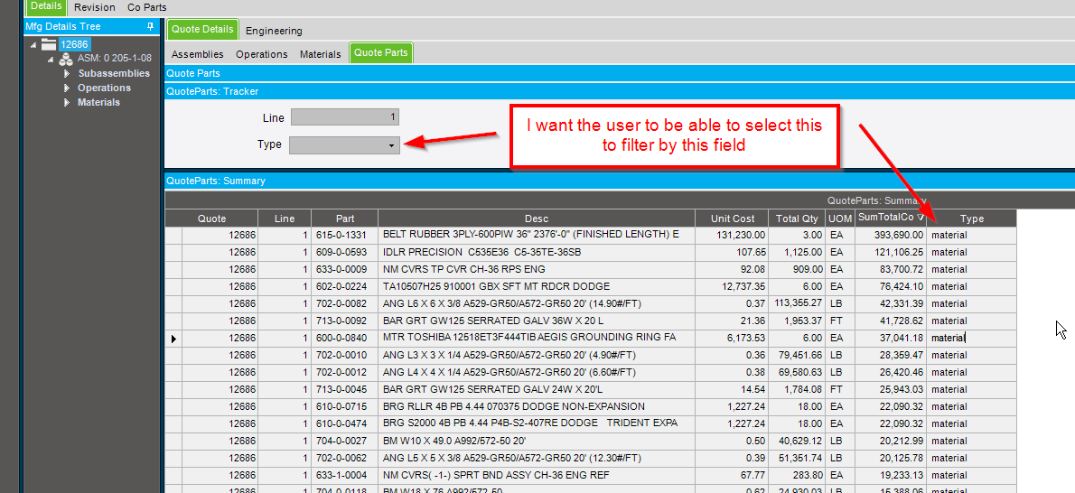

Not I have another question about this subscribe. Am I not allowed to have mixed subscribe/not subscribed fields? I want to have a tracker that allows then to filter by type (a calculated field created in my union query). When I add it to the dashboard, it works there. But in the embedded grid, it makes in disabled, even though it’s not set to subscribe to anything. Is there any way to make this work?
