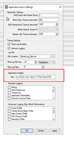

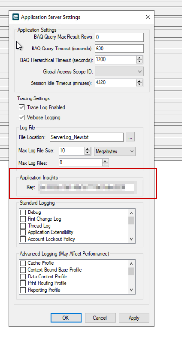

so I believe you can have it show up in Application Insights
There’s an app insights Key in Admin Console which you can change to yours
I haven’t tried it yet… but seems promissing.
Which I think answers @Mark_Wonsil 's idea… mostly.
They did add so many nice logging options right to that gui, I was happy to see that. They were flags I believe, which was fine.

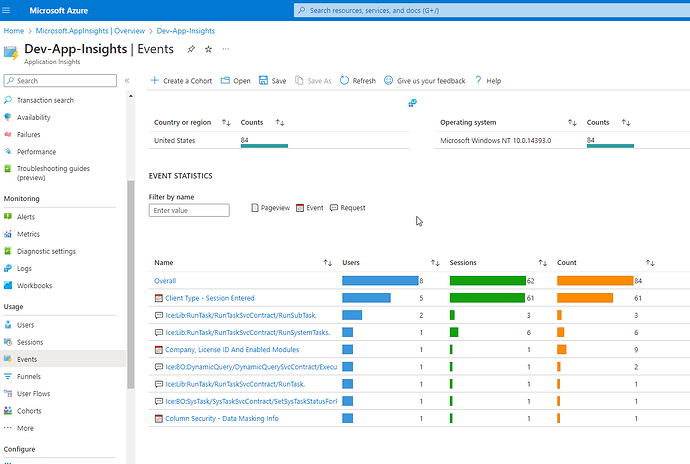

So I changed the key on my dev environment and stuff started flooding in
I don’t understand much of it … but its there.

I’ve been trying this out this morning, and sure there’s lots of information here.
I would mainly want to be logging the exceptions. I’m not seeing anywhere in the portal where an exception is logged.
Take this entry in the text log for example:
There doesn’t seam to be anywhere in the application insights portal where this exception is visible.
In fact, I’m not seeing anywhere where the response code is anything but success! Response time matches though.
