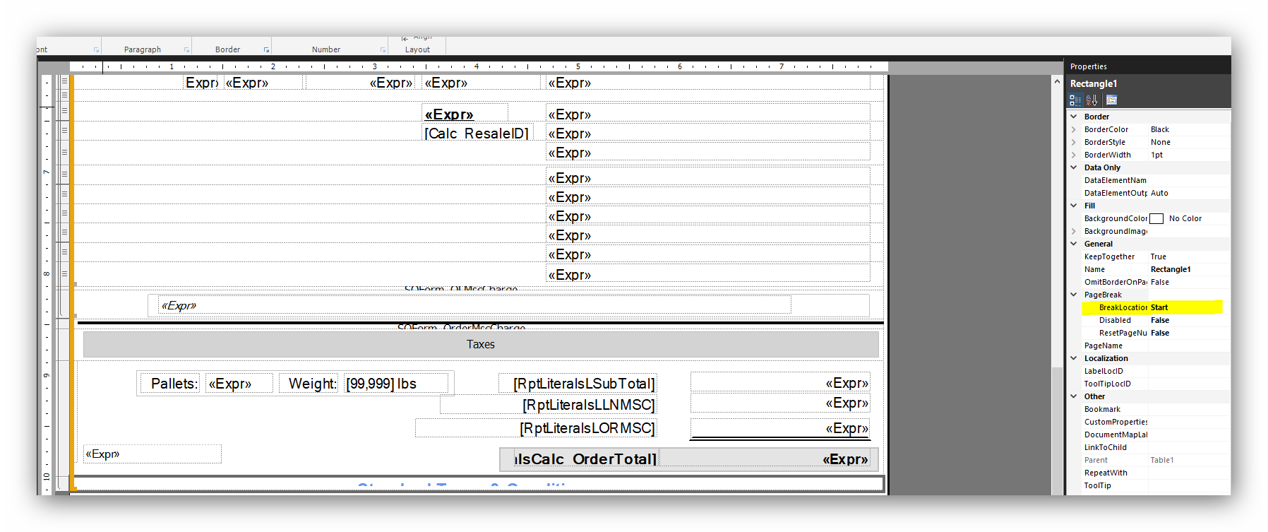

The way I set up our T&Cs was to add a rectangle object and then in its properties, set the Page Break property to Start. You can then add a text box inside the rectangle and paste your text inside. It will start on a new page.
We have ours in our Sales Order Acknowledgement form. As the last row in the Order Number Group we added a row with the rectangle inside of it. Inside that rectangle is a textbox with our T&Cs.
