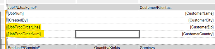

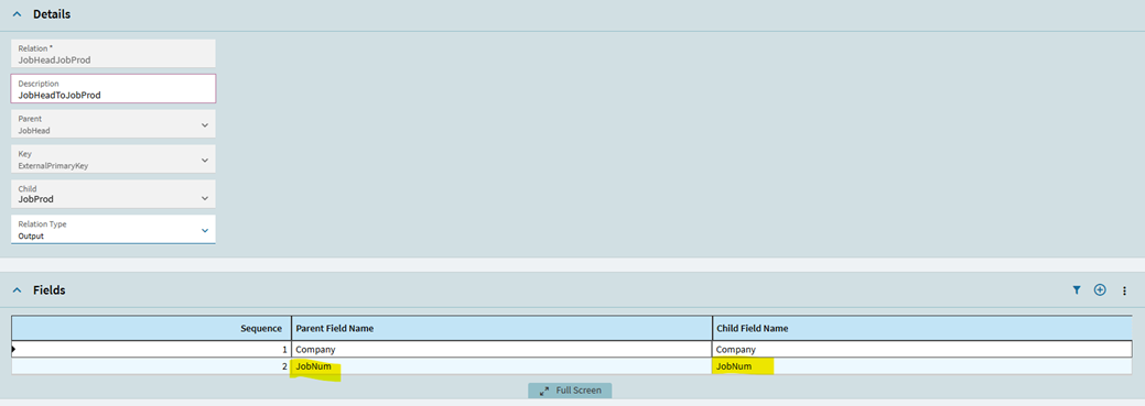

It took me a while, forgot to uncheck Company exclusion in RDD, but whole process goes like this:
Added “JobProd” table to RDD
Added relations
Edited exclusions
Then in SSRS rdl file Traveler.rdl edited main JobHead dataset. Not so sure about how I did that T9.OrderNum as JobProdOrderNum, maybe its enough to sau T9.OrderNum, will check later.
Plus added Fields in Fields Tab. Pressed refresh fields.
As we can see - we have new fields inside JobHead dataset
In main design field added these few rows and these two fields (I already made Grouping before, JobNum as parent and PartNum as child)
Ini EPICOR pushed for new report:
So far so good. I can see rezults. Tommorow will try to do weight part
